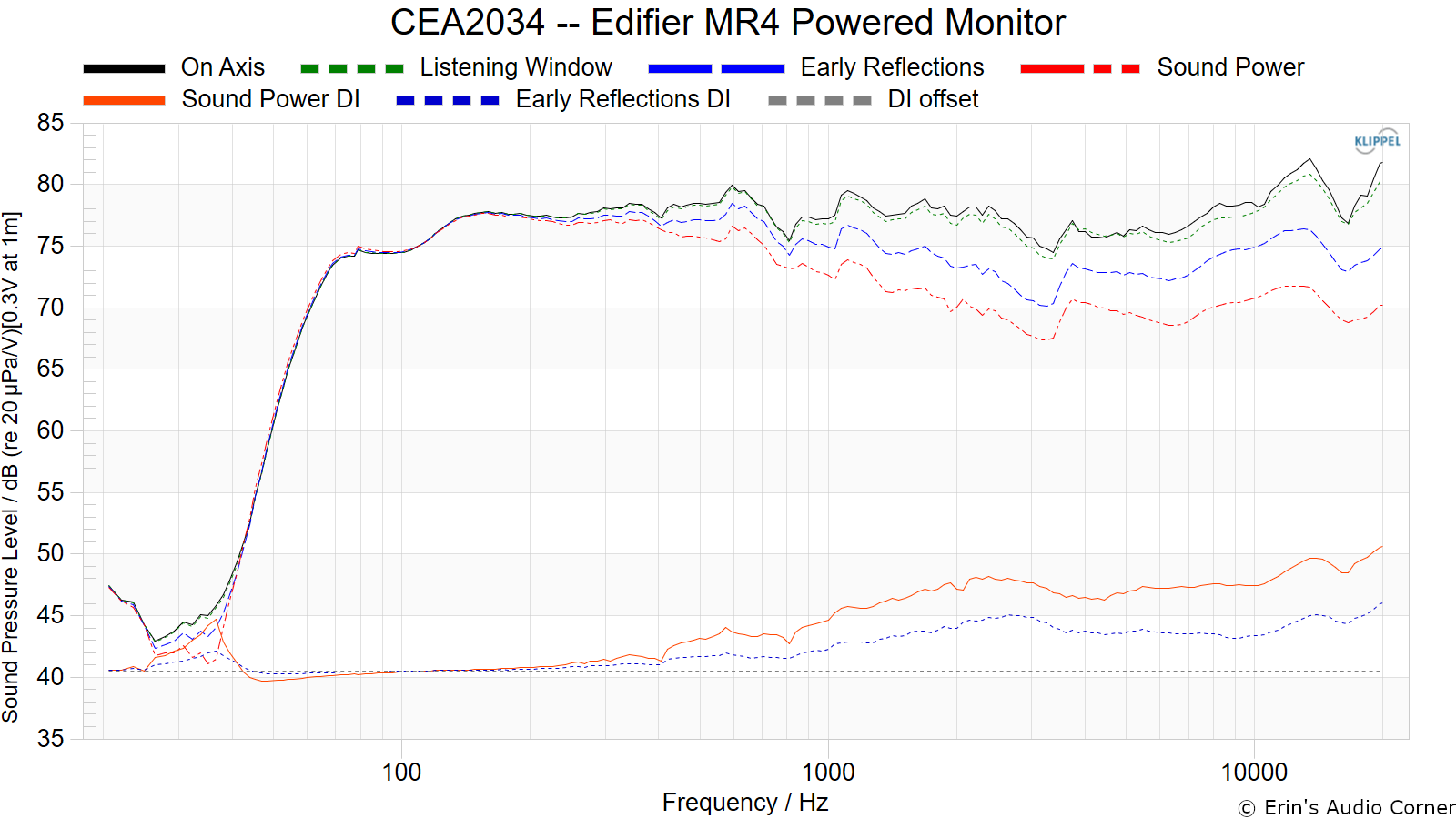

This time it's the Edifier MR-4 (same model that Amir reviewed previously):
Edifier%20MR4%20Powered%20Monitor%20Horizontal%20Contour%20Plot%20%28Normalized%29.png
Obviously, loudness limited. Use nearfield only.

Erin’s HF is again showing more rise than in amirm’s measurement.
So I should have written VHF. It is the same frequency region that came under scrutiny in the review of the March audio speaker.
Potential reasons:
  • I'm using a different mic (yes, with calibration file)
  • I have a modified boom that puts my mic at the end of a tube; Amir uses a towel wrapped around the mic holder at the end of the boom. I created a video on my modified mic boom so this is public info
  • Exact positioning (if Amir is off even a little bit that could lead to differences in the VHF)
  • Settings (I assume Amir used the same settings I did)
  • Unit-to-Unit variation (it's a tweeter, it's beaming at this point). And it's in a $130 pair of powered monitors. So...
I'm not saying my setup is better so let's nip that in the bud. I'm saying those are the differences and could be contributors. These will always be potential differences anytime you compare anyone's results.
The issue with the March was resolved on the manufacturer's end. This was stated by the manufacturer himself and shared by me in the March thread.
In other cases Amir and my measurements have been right on. Other times they aren't. FWIW, even the CTA-2034 spec states that differences of ±1.5dB are perfectly within reason. I'm not sweating this stuff.
