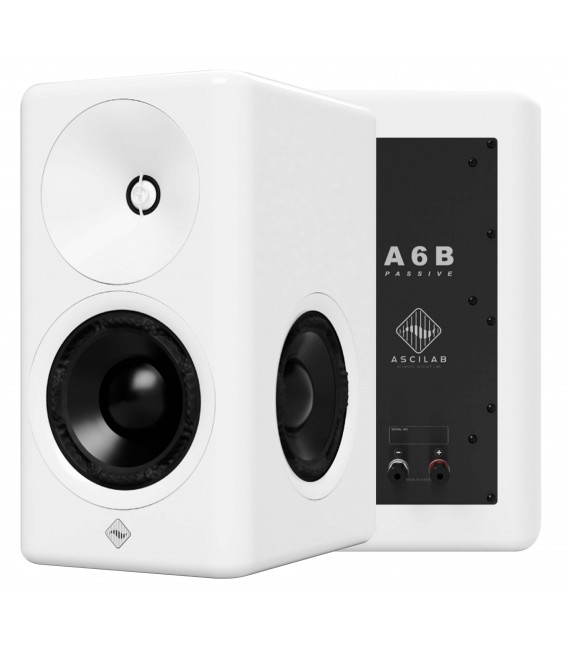

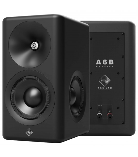

Sorry if this is a stupid question, but I can't tell from the photos/videos: is the passive radiator on each side of each speaker, or just on one side?
If it's on both sides, would this speaker be a bad choice if the edge of an OLED TV was pushed up all the way to the side of the speaker, between the front of the radiator and the front baffle (i.e. so it's not touching the radiator, but pushed up to the side right in front of it?
The PRs are mounted on both side.
If they don’t touch the TV, then nothing matters.
You may have a little bit of interaction between the wall and TV and having a "barrier" of sorts.
More importantly, the TV being so close is going to behave like a bit of a baffle for frequencies that wrap around. There may be a sensation of more bass and mids.
Yes. Near wide surface makes the baffle step different. My answer for @bergfe was about PR hitting the TV or not.
