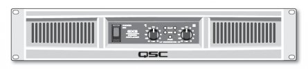

HI! One thing isn't clear to me. here it says input sensitivity 1.2Vrms...but then it says maximum input 16Vrms.
Can you explain to me, please, why this big difference?
The amplifier has adjustable gains. I use it for a couple of subs.
...and....Is the 1.2v (approximately) output of the 3600 called Vrms? Or peak to peak? Thx

Input sensitivity is the minimum input voltage that is required for the amplifier to reach its full power output. The maximum input voltage is the voltage that the inputs can handle before clipping of the waveform occurs.
Thanks for the reply, I had this idea too. Now I have confirmation of it. Is the value of 1.2Vrns valid for any of the 3 inputs?
According to the specifications, yes it doesn't matter which inputs, 1.2 Vrms will give you the rated output as long as you keep the gain adjustment the same for each case.
This is a class B amplifier, audiophiles typically would not use it for hifi, but I am sure you know that already.
ok, thanks for the information. Yes, I know audiophiles and their thoughts. It's great to my ears! :)
...mine is class H. I don't know what "2-tier" means though. Maybe you know it!
Okay, but you circled the 1.2 V in that attached photo under the GX3 column so I thought you had the GX3, the GX5 is class H, but it is mostly class B as well like the GX3. It has "2-tier" rail voltage, that's why they call it class H. 2-tier is the basic type of class H, there are some more sophisticated class H that has more "tiers", or even use infinitely variable (analog) supply rail. Those are sometimes referred to as rail trackers. This kind of class H is done to increase efficiency even further than that of the class B's.
