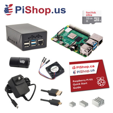

If you are already running Roon, a Raspberry Pi can be a simple streamer with the Ropieee OS:
ATM, RPi hardware can be difficult to find at a reasonable price, but some vendors have them available in kits like this:
If you want S/PDIF output, you'll need an add-on board and a matching case:
If you can wait, Roon support is on the WiiM Mini development timeline for the end of the year; cheaper than a RPi, no assembly required, and optical out!
