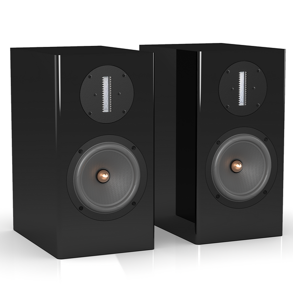

Ascend Sierra 2 Speaker Review
This is not true. The EX woofer covers much of the midrange as well and is more linear in the midrange than the S2 woofer. I've talked to Dave of Ascend and he says the EX measures more flat and sounds more neutral - the original S2 has a rising response that even he admits.

People might want to check the Ascend forums regarding the upcoming Sierra LX designed with the aid of the Klippel NFS. 2 way dome tweeter bookshelf pref score 6.92 without sub and 8.62 with.
Looks really good. Great to see manufacturers posting NFS results themselves. Things are changing :).
Dave purchased the Klippel NFS after the ASR review of the Sierra Luna. Ascend has always been about publishing measurements. It’s just that most smaller companies don’t own a Klippel NFS due to the high cost. It’s nice to see that he’s not the type to let things pass and he had to investigate the issues himself leading to adjustments (a foam insert) at the port to deal with the identified issues. The issue is with the larger makers who have the resources and still don’t publish their data on line forcing us to wait until JA publishes the measurements on Stereophile but JA does not have a Klippel.

Dave has launched the Sierra 2 EX v2. Measurements look excellent and can be seen on the product page.

Yea, they just released the V2 tuning of the Sierra-2EX optimized with the NFS:
There are additional NFS measurements on their webpage. They're selling this new V2 version and offering a crossover upgrade kit for current owners. On their forums it sounds like something similar is going to be released for the Ribbon Towers soon. One of the pros of buying an Ascend is that they design their new releases around the ability to upgrade previous versions. You don't have to be afraid that you'll buy an expensive speaker and a new one will come out next month leaving you with buyers remorse.

Sorry I know you're a fan but the Horizon measured quite a bit better than the towers, there is a lack of bass compared to 200Hz+ region that is all a bit elevated in comparison. Nothing that a little EQ couldn't fix but there is room for improvement and it sounds like the V2 version will be just that.
I just upgraded the Sierra 2 EX to the V2 version. The improvements are apparent, not huge, but well worth the cost of $135 per speaker. It's more linear with better in-room response and off-axis behavior. Subjectively, it seems warmer with more spaciousness than the EX, which was already a fine speaker, itself. Having an NFS during the speaker's developmental phase is a game changer for Ascend. Well done.
