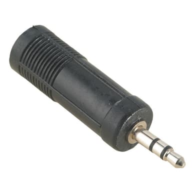

So for the long from explanation, as y'all know the most common 6.3->3.5mm adapter is like this:
Now, the problem is it protrudes from the device a lot and is "solid". So aside from taking a bit of space from a desktop if you tug at the cable or accidentally "poke" the adapter itself - things happen! - it causes quite a bit of torsion or whatever you call it on the plug as well as the input it is connected to. It's basically like a bloody lever. Previously this had caused for the front 3.5mm audio input in my PC case to break - probably the terminal's actually at least partially loose from the PCB, though I haven't taken it apart to verify. Doesn't work, regardless.
I wanted to avoid that with the DX3 Pro+ in any case even though its input port seems solid, but still only had the above kind of adapter. However before long I started noticing some annoying distortion here and there in the sound, and noticed the plug had problems fully "seating." Well, turns out that it was a bit bent from the above circumstances. Bending it back allowed it to seat properly but didn't stop the distortion - in fact it increased a lot. Not sure why it worked better with the previous DAC, maybe the less "sunken" input port - though after straightening it certainly didn't anymore when I tried. My ears!

Sadly, you learned this lesson the hard way, but if you look around there is a ton of advice online to never use a rigid adapter like that one, and it’s a bit of common sense too (not saying that in a dickish way). Flexible works better and it shouldn’t really matter which the DX3 Pro+ uses because everyone has different headphones and everyone has good adapter options available to them.
