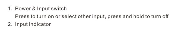

Well maybe on the speaker output.... and its a Switch mode power supply.
So there are Switches but i don't think this is what is meant.
Standby to be precise

I think that button on the front panel is a Standby mode - low power consumption mode, 1.2W. So while in standby mode, AC is still coming to the power supply, and the power supply still delivers the +/-30V DC to the amplifier. The only way to shut down the AC/DC power supply in to unplug the AC from the 120V / 220V socket.
I shut mine down completely with a power sequencer. Hope I am not damaging them. So far so good. I mean are they supposed to be left in standby? Sequencer applies AC to brick then provides 12v trigger after a delay. Upon turn off just the opposite.
