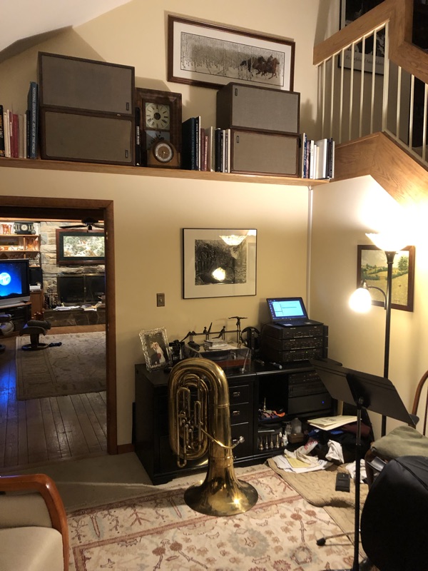

Any box speaker in a normal room will generally excite resonances in the room between 40 Hz and about 120 Hz, add to this the overhang of bass energy released by the speaker / cabinet after the initial driving current has fallen away and you get a particular sound, which can be boomy. EQ schemes like Dirac can reduce the initial resonance but can do nothing about the stored energy that is smearing the sound. We have become used to this sound as far as bass reproduction goes, and to many this can sound "right" with good "midbass slam" if the bass is not too peaker in the ~80 Hz realm.
As noted by Linkwitz ( see https://www.linkwitzlab.com/rooms.htm ) dipole speakers - open-baffle woofers and panel speakers of any kind - excite these room resonances far less, and also don't exhibit the slow release of stored energy from enclosures like box speakers do.
Will never forget, when I worked at one audio store in the 80s, a guy brought in a cassette tape of his favorite test tracks...
First song was Emerson Lake Palmer "Lucky man" and he cranked up the volume, hit the loudness and we ran it through some large JBL towers.....
OMG the boomy bass notes are etched into my mind to this day. I remember stuff vibrating in the room and trying not to laugh at how boomy and crazy it sounded.

(one of a pair of Original Economy Utility Advents currently ensconced in the basement)
The Recoton-era Advents with (also cheap) dome tweeters, though held in low esteem by the kind of folks who collect OLAs and their Kloss-era kin :p, had much better treble to my ears ;) than did the OLA and kin.
(Dump find Advent Legacy II - one of a pair - after [generic] woofer refoam)

Edit for pictures (far different from the current arrangement!):
Stacked Advent NLA's, deluxe on the bottom and utility on the top. The Utility NLA pair I bought new in 1977. The Deluxe pair came much later.
