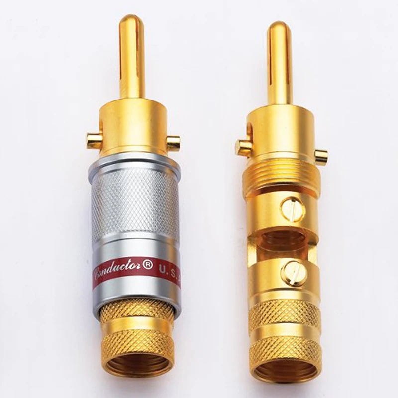

John, do you then attach a banana plug to the end of the wire, or do you just insert it into the hole on the screw terminal and tighten the nut?Tinning with solder is so 20th century... Brittle, subject to corrosion and compression. Not a good idea for any type of low resistance clamped banana or screw terminal. Pretty sure it is 100% illegal for anything mains rated here.
Ferrules are infinitely better, and required in EU countries in order to obtain CE marking. Here's a couple I just crimped up on a scrap of wire.
round die brass:
square crimped tinned copper ferrule:
Do ferrules decrease the contact space between the wires and the amp/speaker?Ferrules are infinitely better
Yeah, bananas suck. I hate using them to hook up power in the lab. I would never use them for signals I cared about.View attachment 205382
