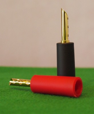

In my multichannel multi-driver (multi-way) multi-amplifier stereo project, I need to use so many (and rather long, in my case) SP cables. I have been sticking to very reasonable (cheap) tin-plated Y-lugs and AWG10/AWG12 multicore vinyl cabtyre cables with great satisfactions as I shared here and here.
After my 30-year try-and-error journey, now I definitely believe that these very cheap tin plated pure copper Y-lugs and R-lugs are the best terminal-contact solution since rather soft metal tin plate effectively increases the contact surface area when tightly connect and squeeze;
Furthermore it is critically important to eliminate any magnetic susceptible metals in handling of speaker level signals as I shared in my posts here and here.
You can find the latest backside cabling photos of my amplifiers and SP drivers here on my project thread) and here (post #636 on that thread).
As shared here, nowadays I seldom use banana plugs.
In case if I would use banana plugs only tentatively, I always use Audio-Technica's solder-less two-screw banana plug AT6301;
https://www.audio-technica.co.jp/product/AT6301
The pros of AT6301 are;
- reasonable price (JPYen 1,980 [USD 14.85] for four plugs, two pairs)
- rigid and well QC-ed gold-plated plugs
- the two screws are well (precisely) manufactured and can be fixed tightly
- the outer vinyl (ABS resin) sleeve is complete insulator
- the outer vinyl (ABS resin) sleeve can be screwed-in "after" the cable connection
