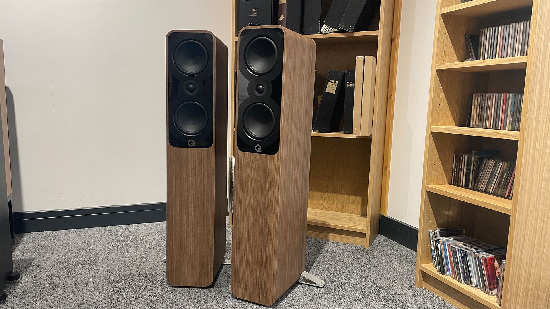

Thread bump. A bunch of audio designer/engineers (of varying technical backgrounds I assume) interviewed claim break in is a thing. They are all industry connected, so may benefit from claiming break in is legit process. They are, to give them some credit, less adamant about electronics.
Ask The Industry: hi-fi engineers weigh in on the value of 'running-in'​
“There's no argument as far as we are concerned,” says Stephen Oakes of Neat Acoustics, and “it’s pretty clear cut” says Cambridge Audio’s engineering team – loudspeakers benefit from being run-in due to their physical and mechanical nature. “Loudspeakers straight out of the box will certainly sound ‘tight’ and far from the relaxed performance that is desired,” says Peter Comeau of the IAG Group. And Oakes affirms that “this is audible and measurable”.
Why? Well, firstly, drive units are made up of moving parts that are stiffer than intended when new and unworked. “The most obvious thing is that speaker bass cones and, to a smaller degree, tweeters move, thus moving air,” says Paul Mills of Fyne Audio. “It takes a while for the speaker surround, which is often rubber, and the rear fabric suspension to ‘ease up’”.
You then have the spider that makes up the majority of the total compliance of a woofer. This, says Oliver Thomas of PMC, “will have various coatings to optimise its mechanical and acoustic properties to meet the design goals, but these coatings set harder than intended when first applied, and will gradually soften to their final state as the parts are flexed and stretched during use. The practical effect of this is that the measured resonant frequency and mechanical damping of a drive unit will shift during the first hours of use, which in turn will alter the drive unit’s acoustic behaviour”.
Cont:
Cont:
