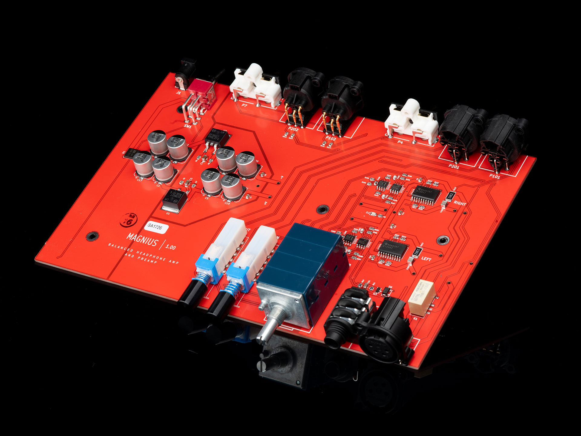

For those who have the Modius and want a matching fully balanced amp with the same chassis and much better pot than the Magni Heresy:
https://www.schiit.com/products/magnius
@T.M.Noble Are you sending one to Amir for review and measurements?
Interesting to see it is also a composite amplifier based on the TPA6120A2 part (analogue to A90, but with a pretty different take on it of course). Powered by 24VA 15VAC transformer, +/- 13.5V rails.
