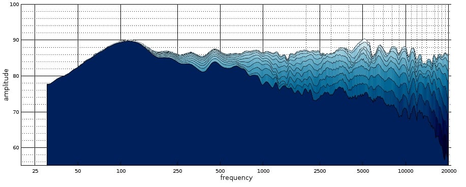

Is it possible to EQ the bump centered at 120 Hz?
It's unfortunate that bass hump doesn't start just a little bit lower, so it could be avoided via ~80Hz crossover. When used without a subwoofer, I imagine these sound great for their size, and that hump probably helps compensate for lack of true low end response.

Looks great, though I would like to see it do better on the distortion side. Is it ok to compare to the Adam S2V? Please note different y-scale.
I agree. IMO anything above 0.5% THD above 100Hz falls into less-than-stellar cathegory of THD performance.
Especially when its due to an odd (3rd, 5th etc) component as those sound much nastier than the even ones.

I'm actually a little fascinated that there is a good deal of constant directivity in the Revels, as shown by the flat directivity index between 1800-12000 hz.
This could be a good speaker to check whether or not a constant directivity design is preferable over a more gradual increasing one in smaller spaces. Don't sell these @amirm.

I do not like the distortion graphics of the Revel woofer. Many are unable to look beyond the frequency response.

A speaker can be spl limited by other things than out of distortion considerations. Amplifier power, thermal limiting, thermal compression, excursion protection etc.
I agree about distortion superiority, but I don't know if/how relevant that is to sound quality in an absolute sense. My guess is that it's far down the list of important things, but frequency response and dynamic capability is up there imo.
