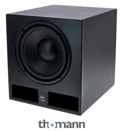

I imagine that this model will sound pretty well with his subwoofer/s:
and some Dirac Live EQ (more precise than PEQ) thanks to its good directivity index
Subwoofer cost here:
