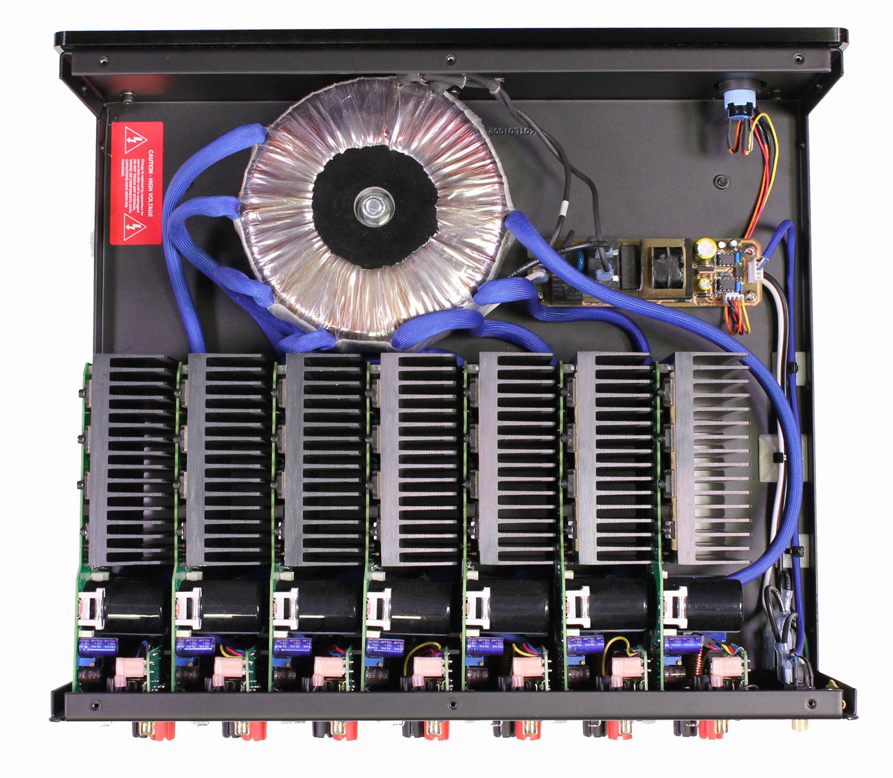

The 7140 is a beast of an amplifier, nearly breaking my back carrying it up to my lab:
The design is highly modular with a massive toroidal transformer powering 7 independent amplifiers, each with their own power supply on board. The heatsinks are rather beefy with plenty of distance between them and top of the unit. The feet are also quite tall allowing better ventilation from bottom to top.
