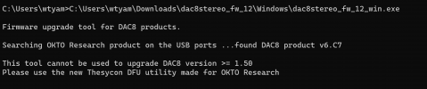

IN MY CASE, I had the following issues:
1. Initial attempts through Windows 11 would appear to fail (looked like nothing was happening). Because of this, I noticed the samples of the process was via the Command Prompt screen, so I tried the update via Command Prompt. It still failed, but now I could see why.
a. It was able to see/find the dac8; however, there was something about either the existing firmware (1.12) or the board build that made it not work (see attached) - not clear what it was referring to with "1.50."
2. Emailed Okto, and Pavel said to try the "other OS" method (using Mint Cinnamon), and that worked - on the third attempt.
a. The first two times, it failed right after the "USB firmware upgrade done." It would not get to the "front panel upgrade" part and the unit would remain at 1.12.
b. The third time everything went through fine, and it was updated to 1.2.
I don't know what made me try 3 times - dumb persistence, perhaps, but I'm glad I did.
I emailed my experience to Pavel, and he surmised that the Windows attempt may have borked something that caused the Linux/Mint method to fail a couple of times...maybe. Realistically, if you already have Linux, it will probably work just as well. I can't imagine there's something about using Mint that would make it work better otherwise. I just opted for Mint because it was the method recommended, and no matter which distro I used, it would have to be via USB boot anyway.

Any other early DAC8 Stereo adopters like myself with firmware version 1.00, try the firmware upgrade?
Mine stays stuck on the following message seemingly forever (using the Linux method):
"Upgrading USB firmware to intermediate version 1.41, do not disconnect...
TaxTime
Mar 27, 2023
48
18
Are you sure you're using the Stereo version of the upgrade - the current firmware in the latest update is 1.2, whereas I the Pro update is 1.5. Both updates come in the same zip file.

I had no success with it, trying to update from 1.11.
Using the Windows update method and file, I can update the driver but the firmware itself won't update.
Using the USB update method and software, which Okto recommends after an update failure, I couldn't even get Terminal to run in the recommended Linux Mint OS. Clicking on it just brings up the equivalent of the hourglass and then... nothing. (Google discloses that others have had an issue getting Terminal to run in Mint.)
If you were successful, how did you accomplish it?

I installed it more because it's the only way their dedicated ASIO driver will work (compared to the previous DIYINHK drivers they used to issue).
There are also a few more controls that are specifically geared to measuring.
I had a similar experience upgrading from 1.11, as I just posted, but, unlike you, I never got the USB stick method to work at all.
According to the instructions for the USB method, I should have been able to bring up a Terminal option by right-clicking in the white space on the Mint Desktop. That didn't work so I clicked on Terminal in the application menu. Unfortunately, that only brought up the Linux equivalent of the hourglass, which spun and spun until I was dropped back to the desktop again.
I gave up after the third or fourth USB stick installation.
Emailed Pavel, but he's never been quick about responding, so I await a response a few days after.

As I posted elsewhere, the update failed with Windows 11. It looked like nothing was happening, but what was actually happening was the process was faulting out immediately so all I saw was a flash of some window. Suspecting it was so, I manually ran the update via Command Prompt and saw it was borking about half way through.
I emailed Pavel and he recommended the Linux Mint method. Note it's NOT that it would only work via Mint, but it's because that is what they used in their test environment, so that is the distro they recommend.
Not wanting to open up the Dac8 to insert an SD with a clean distro, I used Mint loaded as boot on a stick. Note that when doing so, you usually have to change the boot parameter in your bios, and it can take quite some time for it to actually boot to a screen (my W11 mini pc took about 4 or 5 minutes to finally boot to a screen).
I ran the update via Terminal, and it actually failed three times, but being stubborn, I tried it yet again, and it finally took. Pavel thinks Windows may have disrupted something to cause the update to fail with Linux (at least for a few times).
During failures, the process was not getting to the prompt about checking the display.
I assume you used Mint Cinnamon? For myself, I had no problem running Terminal once the OS was up and running, though I noticed almost everything about it ran slower on a USB stick.
Thanks. Yes, I used the Mint Cinnamon USB stick image linked in the instructions. The terminal window never opened. As mentioned, I got dumped back to the desktop after the "in process" spinner icon displayed for awhile.
I gave up at that point and emailed Pavel. No word from him regarding Plan C.
