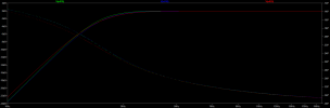

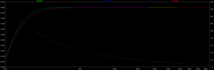

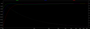

One thing to add, @amirm , when you test frequency response do you drive both channels (mono)? If not, you may not get the correct (relevant) response when the phono stage implements a differential high-pass filter.
Below sim is for a simple 1st order differential highpass together with the common-mode highpass.
Green is for mono which is the relevant case for us (as low bass is effectively mono on vinyl), blue is for one channel driven only, and red is for out-of-phase signals (rumble attenuation).
I drive both channels but for clarity only show one.
That's wrong.

If you add a third pancake on top and knock them slightly askew, you'll have a super Chebyshev filter (0.01dB ripple works well). Easy to get 0.03dB at 40Hz, -3dB at 24Hz, and -22dB at 10Hz!
