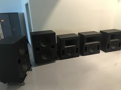

Not my ad, but this is a contender too…
I would go LCR 228be and surrounds 208.
But the price mentioned in the post is bit high.
