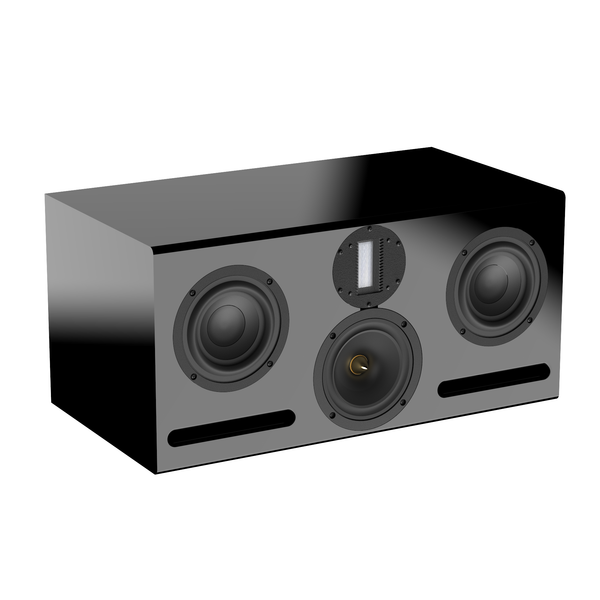

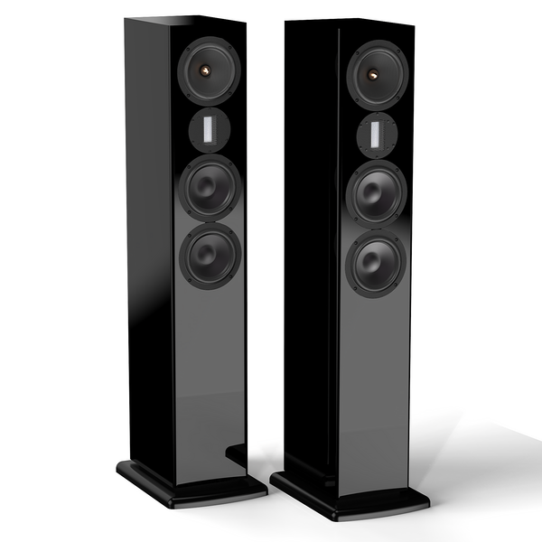

3 pairs of Ascend ELX Tower (Raal) 5300 per pair
Ascend Sierra Horizontal v2 (Raal) 1750
Total 17650
And myself I would not use towers for surrounds and rears, but bookshelf speakers instead.
