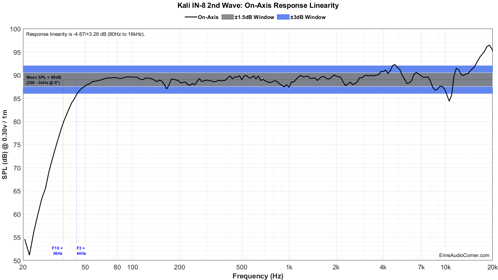

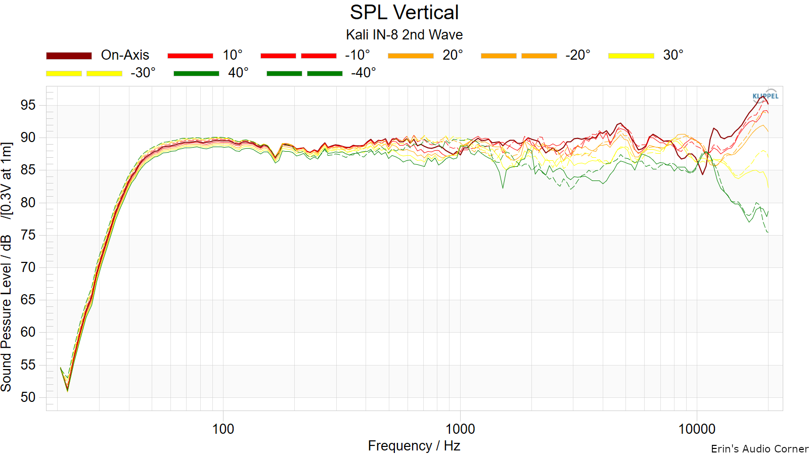

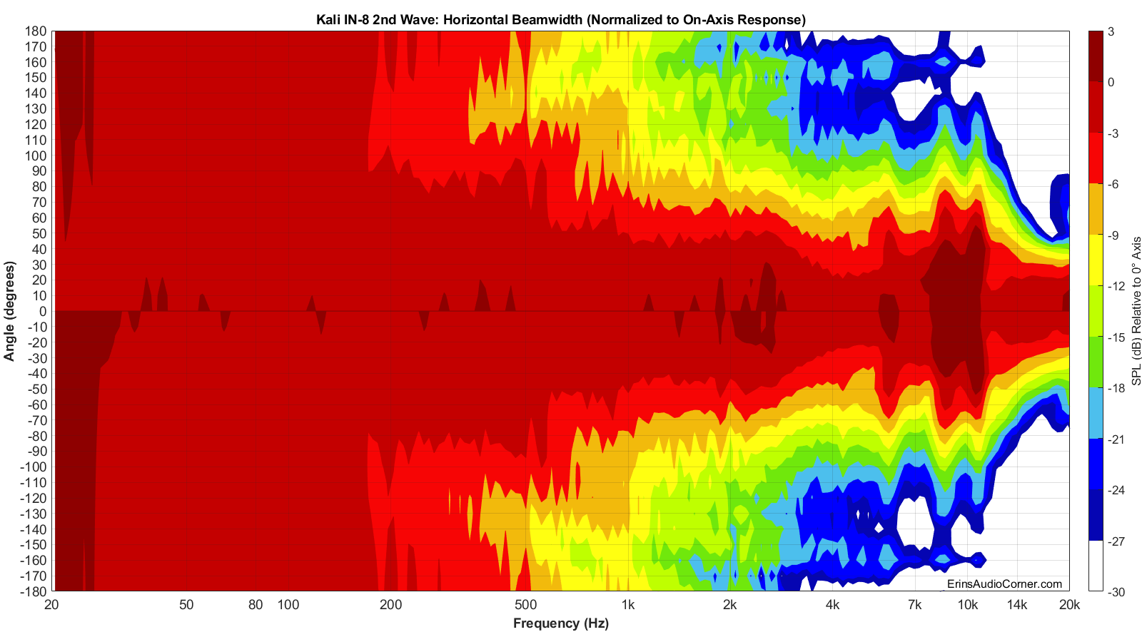

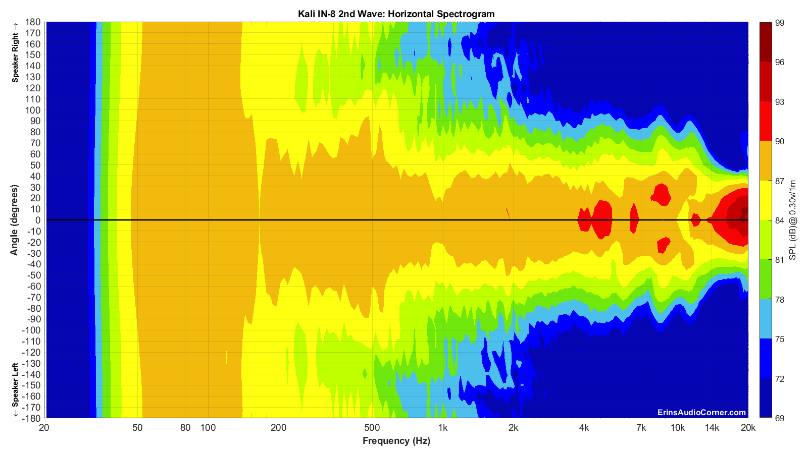

On-Axis Response Linearity

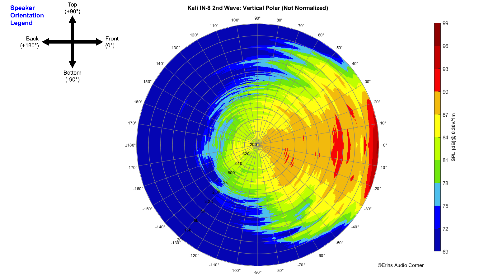

“Globe” Plots

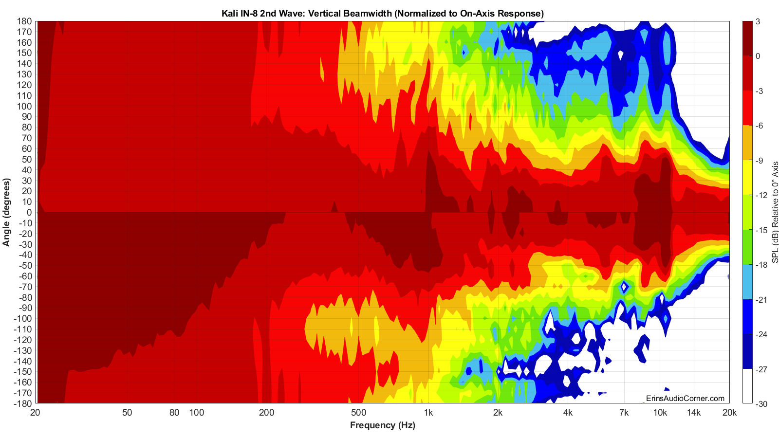

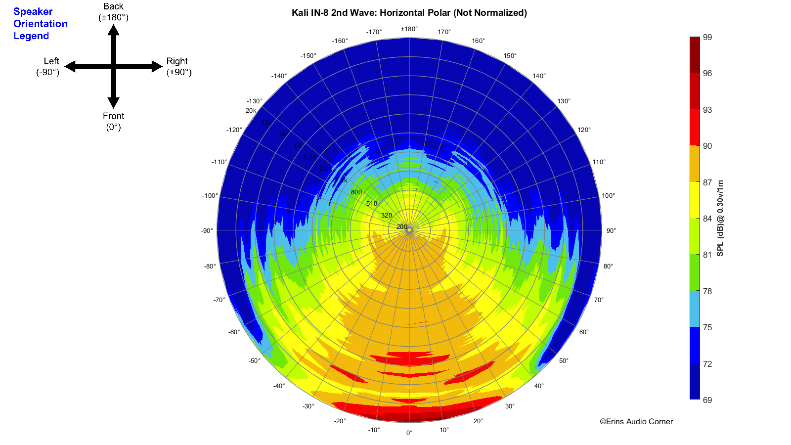

Vertical Polar (Globe) Plot:

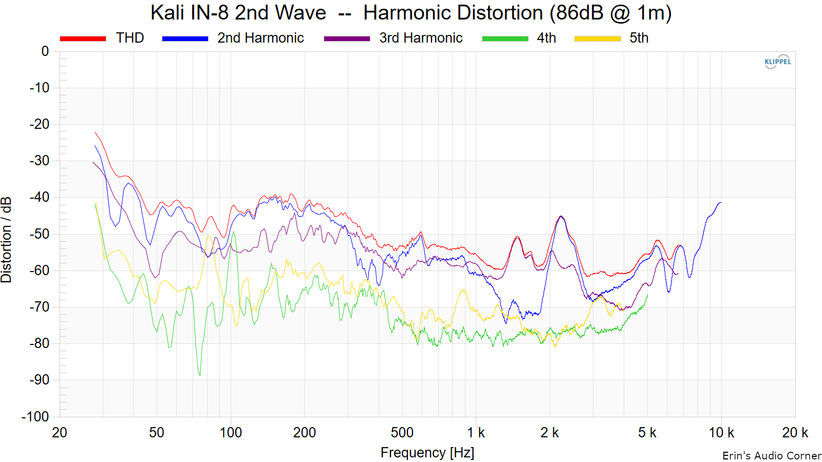

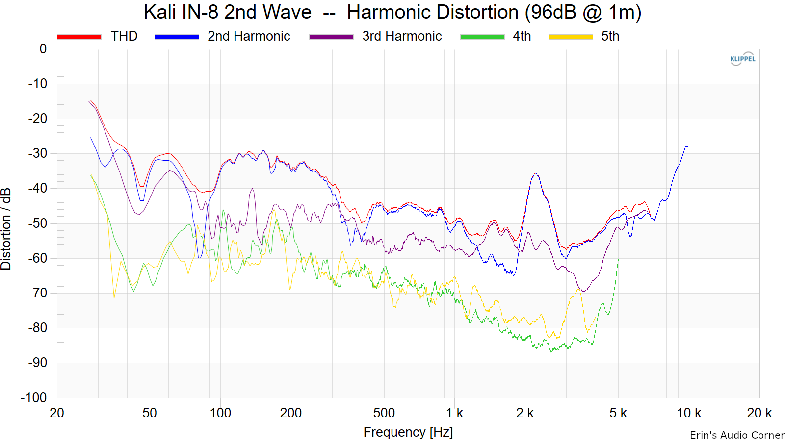

Harmonic Distortion
Kali%20IN-8%202nd%20Wave%20%20--%20%20Harmonic%20Distortion%20%2886dB%20%40%201m%29.png
Kali%20IN-8%202nd%20Wave%20%20--%20%20Harmonic%20Distortion%20%2896dB%20%40%201m%29.png
  2. 86dB at 1 meter (red)
  3. 96dB at 1 meter (blue)
  4. 102dB at 1 meter (purple)
Based on my results above, it is obvious the output is limited (via internal DSP) somewhere above the 96dB @ 1m output level.

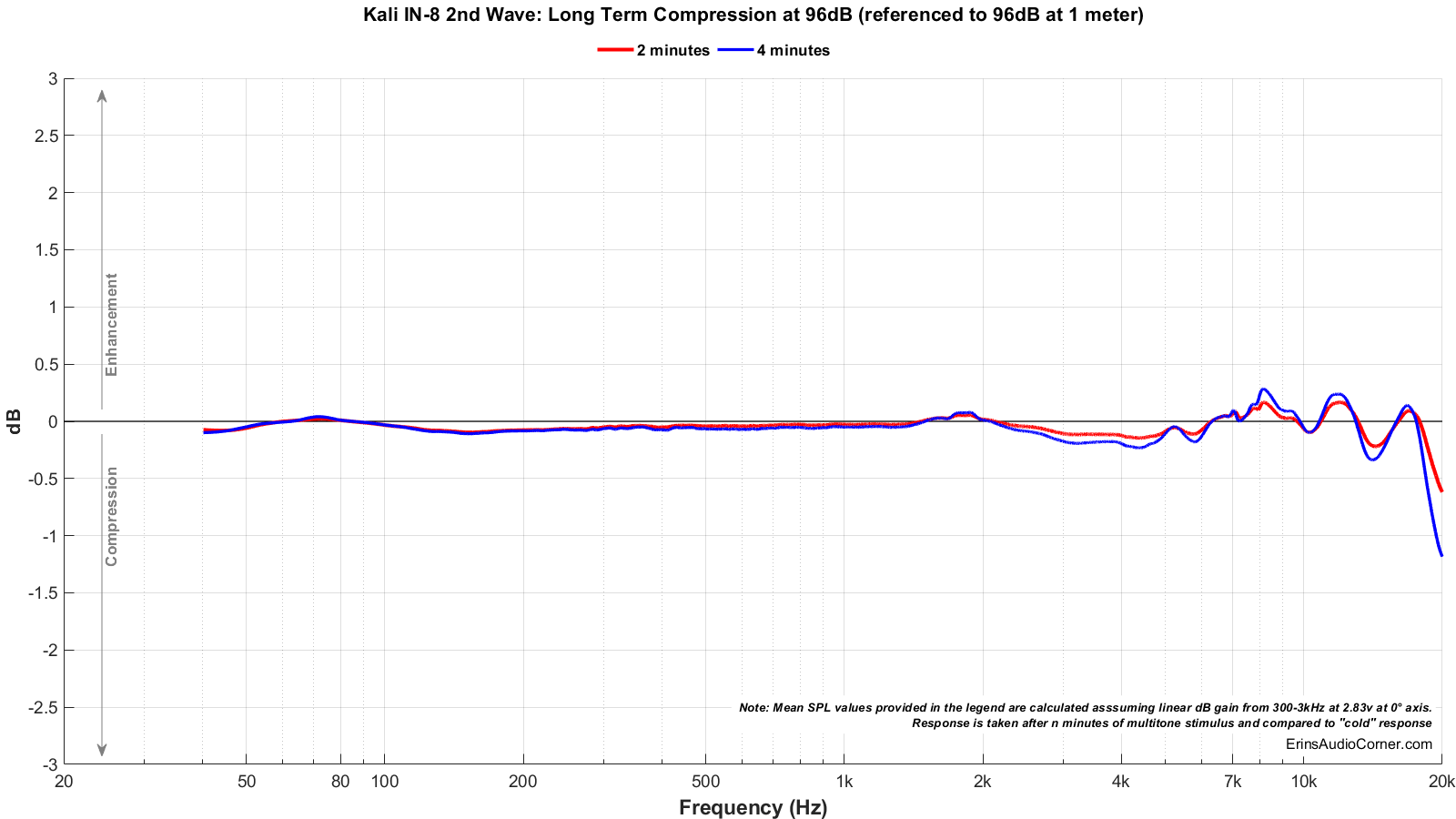

Long Term Compression Tests

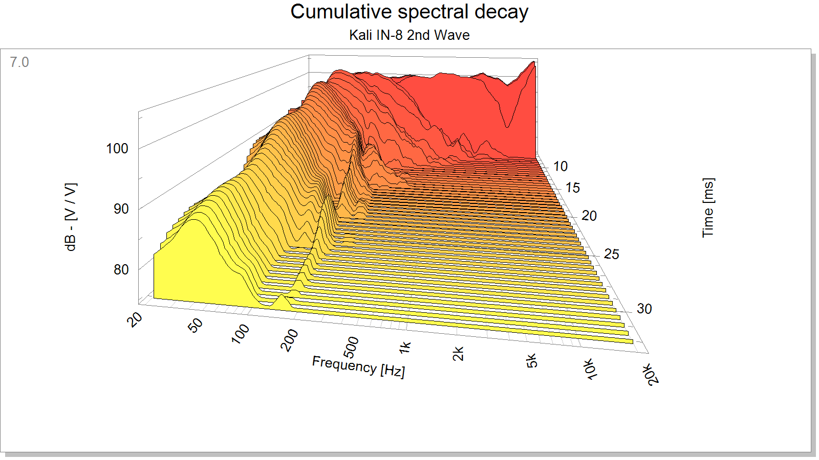

Cumulative Spectral Decay (CSD)

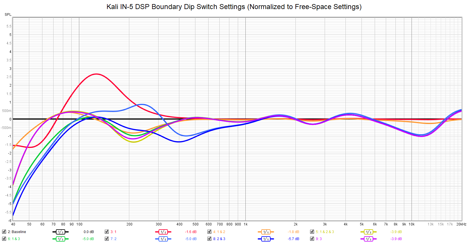

Boundary Settings
I tested this with the IN-5 and am providing it again here. I expect some bit of change from this model but likely not much (and possibly, not at all).
These speakers come with a set of pre-configured boundary settings that can be enabled easily via the dip switches on the back. Below is a close shot of the dip switches.
The dip switch combinations displayed above are labeled and plotted in the graphic below.

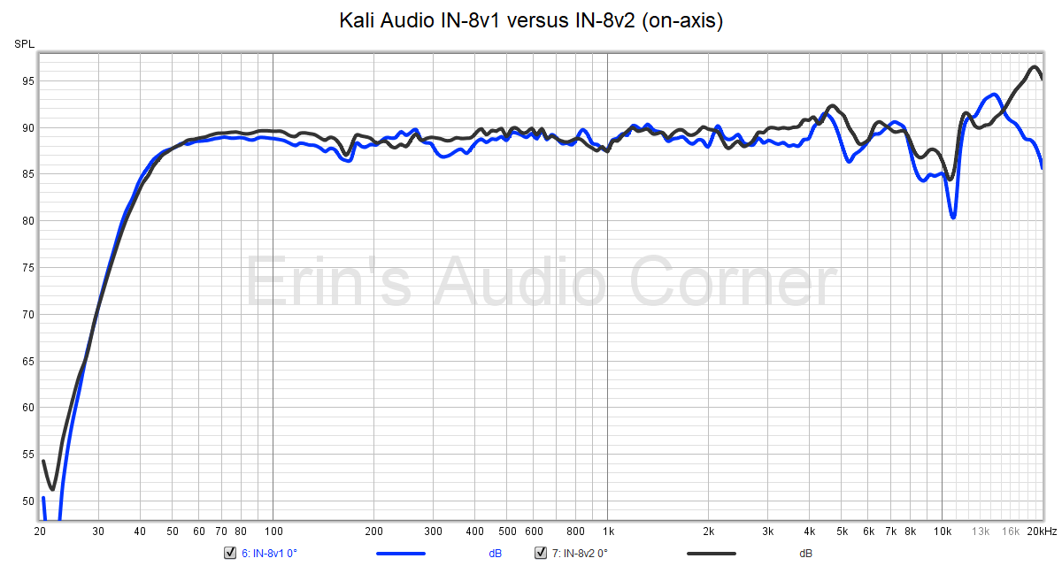

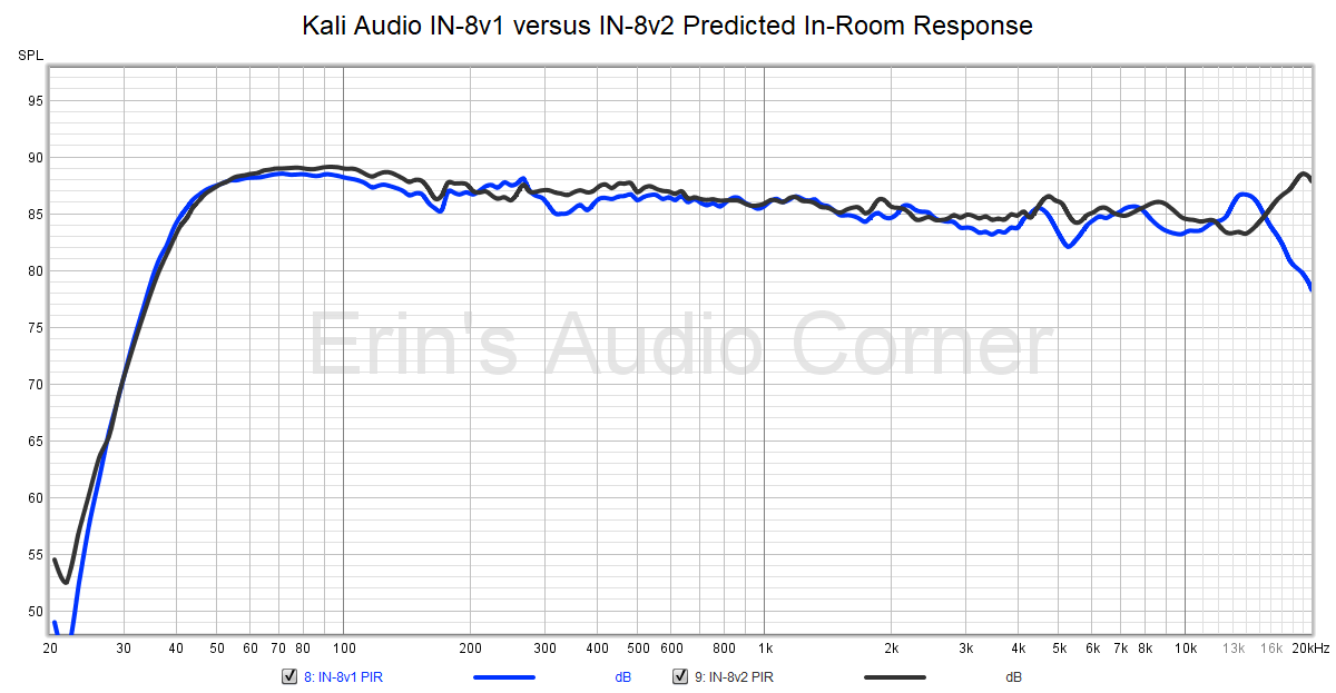

Comparison Against the Kali IN-8v1
  • Blue = IN-8v1
  • Black = IN-8v2
On-Axis Response:
Estimated In-Room Response:

  • The on-axis response isn’t flat but that’s the nature of coincident drivers. You’ll need to be off-axis a bit. Kali recommends 10°. My data jives with this, though, I would also recommend trying them off-axis by about 20°. Your mileage may vary. Just do not make the mistake of EQ’ing the on-axis response as this only alters the character of the sound in a negative way.

  • As for SPL levels, these are marketed as a near/mid-field speaker. My data shows the limiter kicking in somewhere above 96dB @ 1m. I had the output up to about 100dB at 1 meter to stress test with some Linkin Park and there were no mechanical issues that I could hear. I’d say that you could probably use these in the midfield in the lower 90’s pretty well but above that would be pushing it. Realistically, you shouldn’t be mixing music (or listening) above the 85dB range for long periods anyway. I do not know that I would recommend these for high volume listening more than 3 meters but for most volume levels and/or closer distances, a pair of these should be more than enough to satisfy your needs.

Agreed. Exceptional value for a studio monitor. What the heck is that tweeter doin up at 10k on though? Having his own party, lucky its mostly likely inaudible.
Edit: Looks like a trait of the coaxial driver tweeter being in a little tunnel
