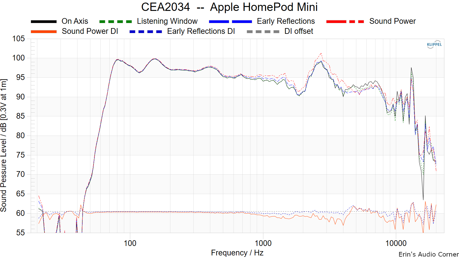

CTA-2034 / SPINORAMA:

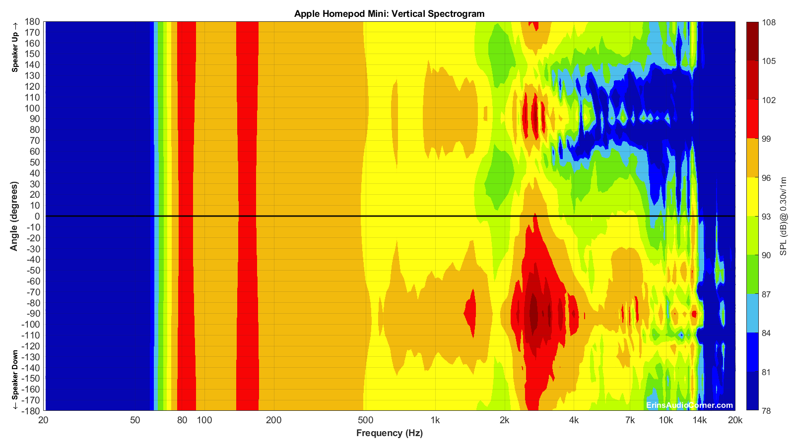

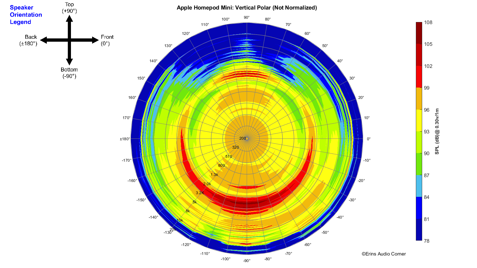

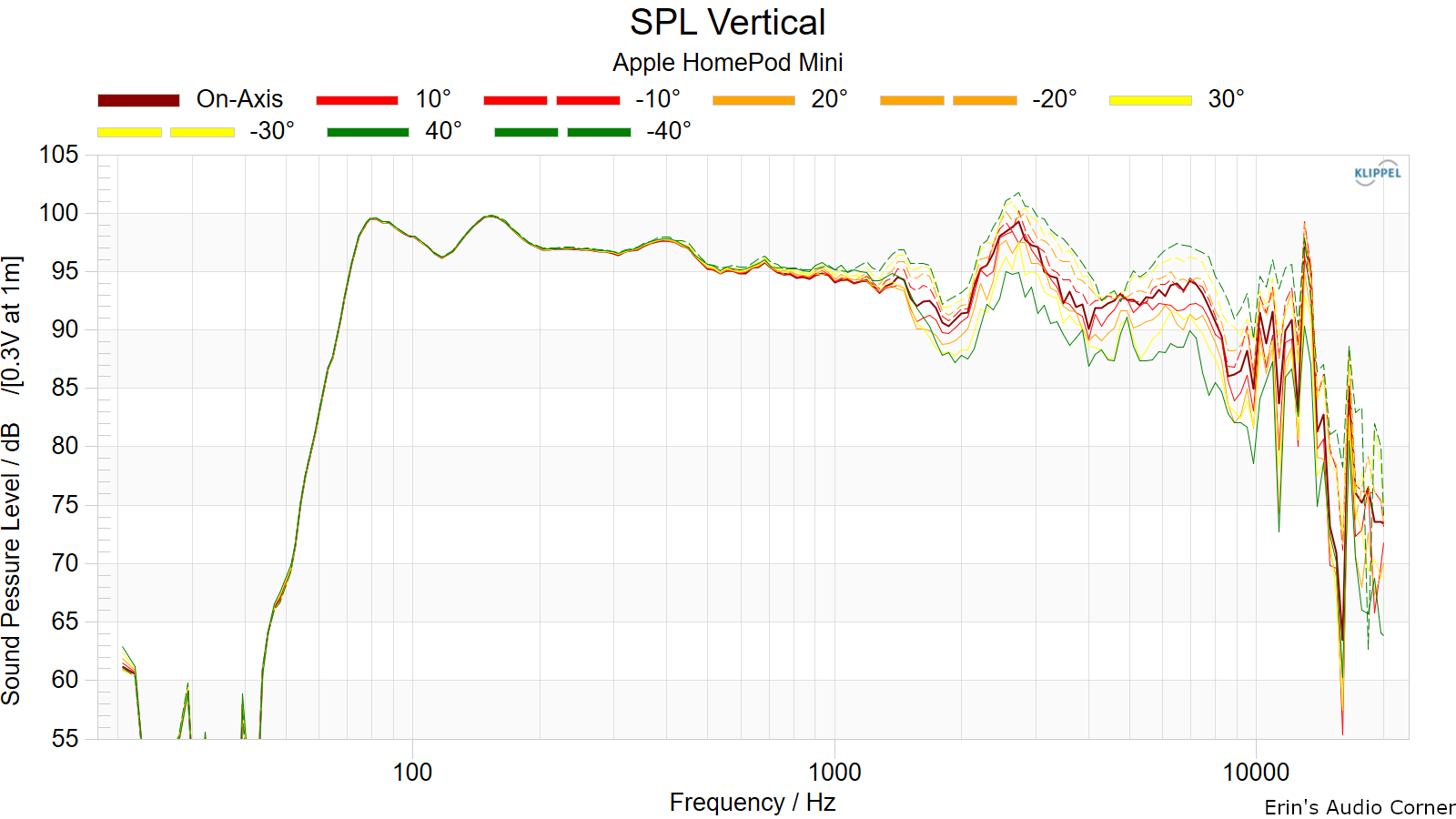

Vertical Polar (Globe) Plot:

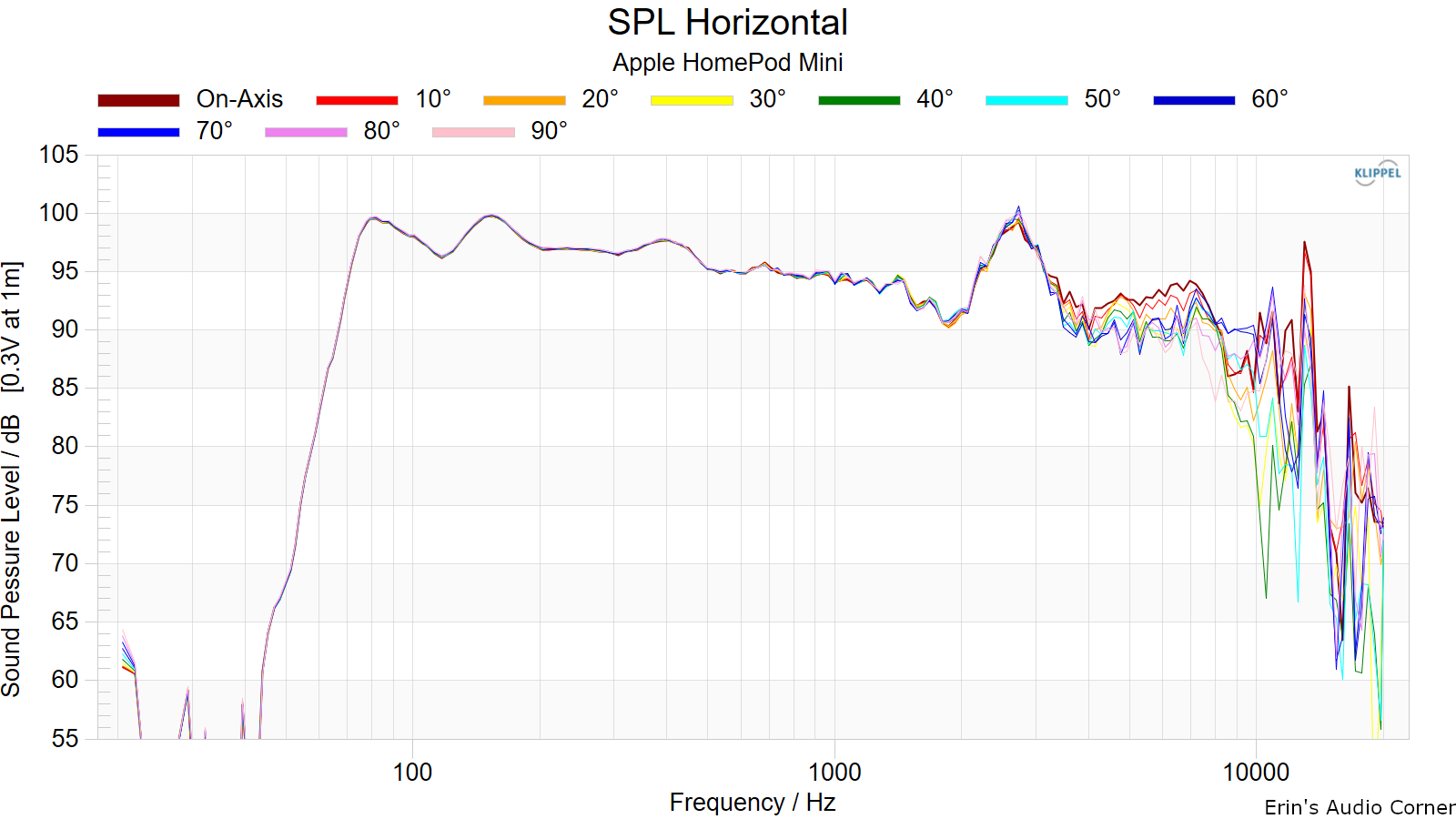

  • The speaker response is practically omnidirectional. I believe the reason you see a divergence in the higher frequencies is due to comb filtering from the power cord that is hardwired in to the unit (the only pluggable end is at the wall-outlet adapter).
  • As I discussed earlier, the high frequency response is likely to be misleading because the speaker is designed to be listened to while sitting on a surface. That will (should) increase the HF output but it, too, will still suffer effects of comb filtering based on the angle of the waveguide with respect to the opening of the mouth. But honestly, as this speaker is likely to be used, I don’t think many will even care. Again, this is not a “critical listening” speaker. It is a convenience speaker. The purpose is different and should be weighed with the analysis of the data. In other words, don’t draw the wrong conclusion; consider how this will be used.

The puzzling thing is that only thing it really needs to be quite good imo for the form factor is to reduce the peak at 3kHz. Directivity is good enough that this shouldn't be an issue. To fix. The other dips and overall tilt shouldn't be major issues.
I do wonder what it would measure like on a table -- would there be a dip in this region? Almost seems like it has to be intentional (sorry, haven't watched the video yet so don't know if it's covered). Or they just didn't care lol
