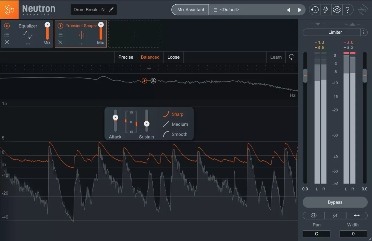

Do this experiment. Use a transient shaper plug-in. Set the attack fast once, slow once. Does the sound sound the same? No. It's the same with speakers, some have a fast attack, others slower. You can add high frequencies and the attack won't speed up, because the impulse matters. Now verify your knowledge and open your mind to the unknown. You'll thank me later.
Transient shapers just use dynamic expander and compressor to shape the attacks and shortens or lengthens the sustains. Which basically is amplitude modulations/manipulations (modifying the waveform amplitude envelope). Picture source here.
Here is how the effect will show up in a typical Fourier analysis. Both have the same fundamental frequency. The "fast" and "slow" waveforms are normalized to have the same total energy. The fast has faster attack and quicker decay. First plot shows the waveforms, second shows the spectra. The fast one doesn't require significantly higher bandwidth to reproduce.
Since these are not a steady signal, pure frequency response curves are not the most sensitive indicators of differences. There are other more suitable ones, e.g. spectrograms or waterfalls.
