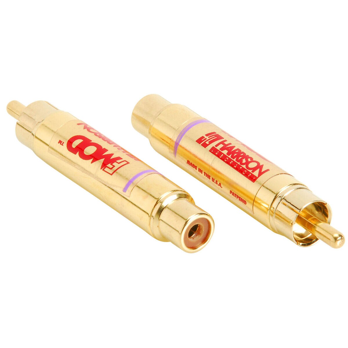

Polk HTS 10 or 12 would be my choice in terms of performance per dollar. You don't need to replace the amplifier, you can try a passive high-pass filter on the RCA input. So you split the RCA output from your DAC, send one pair to your sub, and the other to your amplifier, with the high-pass filter added. Then adjust the low-pass filter on your sub until the speakers and sub blend smoothly.
