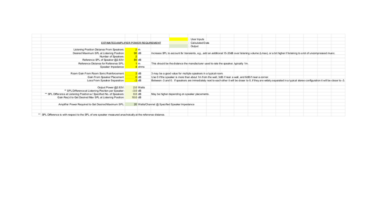

How much power you need depends on many things. Rather than using a "rule of thumb", I suggest using the following spreadsheet to determine how much power you actually need:
Input your parameters in the yellow boxes. The spreadsheet calculates how much amplifier power you actually will need. If that power exceeds the power rating of the speaker, then choose a different speaker.
This implies that I have to exclude from my watch-list the amps Hypex NC502MP and NCx500 as too powerful with 350W and 380W respectively
Too much power is not a bad thing. That is why there is volume control. Just don't crank it up so loud that you will blow your speakers. No reason to exclude those amplifiers from your watch list.
