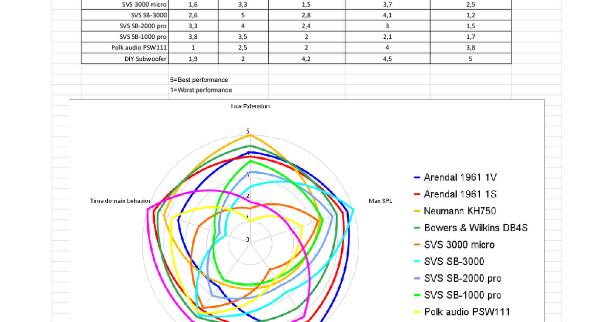

What I was missing was a global overview, and since I did it for a friend who's looking for a subwoofer, I thought I'd share it with you:
5=best performance
1=worst performance
If we can agree that above performance classification is accurate, then I would say that Arendal 1961 1S is the best performing sub while Polk audio PSW111 is the worse performing one.
My question is:
Are they going to be any audible differences between above two subs on the most common(2.1 or 2.2 system, average 75db) music only use case scenario?
That chart is useless. I disagree that the Arendal 1S is best. A sub should have flat frequency response from its low end roll-off up until at least 200 hz. The Arendal has a hump and its low end is effectively rolling off from a much higher frequency.
It is like a racecar driver cutting the corner. If you EQ it to flat then distortion goes up and max SPL goes down. And you do need to EQ it because frequency response is more important than the other metrics and the Arendal 1S is not flat anechoic.
What EQ has to do with it?
All subs in room will be EQ'd eventually and it's way better (distortion-wise also) to have the headroom to reduce levels than to fill dips (where distortion skyrockets) .
Edit:Also why 200Hz?Unless you put the sub really close to mains you will hear a baritone coming out of it already at 80Hz,the combined sound will be like he has a mouth the size of Wind Cave.
That chart shows distortion twice and group delay. If you EQ the Arendal sealed sub to flat (to match the performance of the others), what do you think happens to distortion and group delay?
Because you need an octave for the crossover. A sub should be well behaved in the crossover region and this one will be unnecessarily hard to integrate. 200 hz gets you more than an octave from most x-over points so the sub in a 24 dB crossover is ~40 dB down by 200 hz.
Why would you do that of it's own since will do it with every sub in room,none of them,or any sub will be flat in room and will need to be EQ'd.
It's of the cases that FR is totally room depended so will correction any way.
So it only comes to subs output ability.
I,personally would go for the 1V,it's really out of competition (amongst the tested ones) where a sub really matters (20-50Hz)
The Arendal 1S does well in that chart (distortion and group delay) BECAUSE the frequency response is not flat.
Is the low end extension measured relative to the peak or to the random 80 dB level which was chosen?
