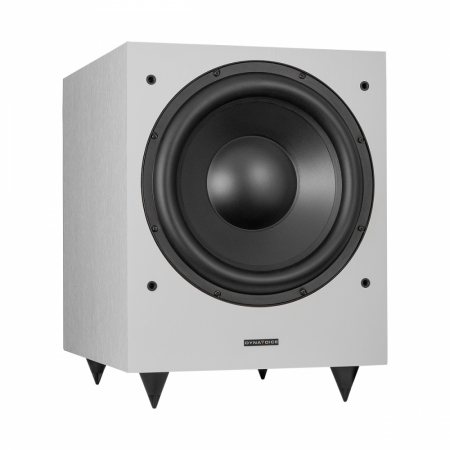

Dynavoice has entered the HiFi market by offering affordable, good HiFi stuff:
Edit:
Maybe goes down to around 30 Hz, which is enough to listen to most music.
Small sealed subwoofers have to work hard. I wouldn't have chosen one with a 180 W amp like it has, but two such pieces can be good. It depends on what volume you usually play at.:)
Edit:
It applies to the entire solution. The amp and speaker driver (in the small box) have to work hard with a small sealed sub. Increased risk of driving the amp into clipping (if there is no built-in limiter) plus the speaker element together with the solution can distort (fortunately we are less sensitive to distortion in the lower registers, but sooner or later the distortion becomes audible).
(amp clipping sounds much worse than speaker distortion, normally)
I just realized that you are a fellow swede! :)

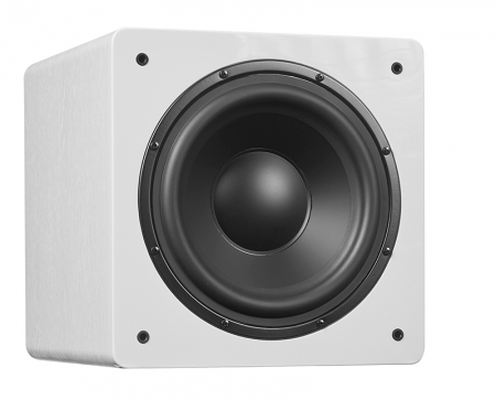

Showed the Dynavoice to the wife and she gave it a thumbs up. It looks alot like the white SVS SB-1000 Pro but much less powerful? I have done some basic messuring with the phone and played with volume. At 2m it peaked around 80-85 db. Most of the time much lower.
Would you suggest SB-1000 Pro in my situation? I would rather "overbuy" than "underbuy" .. which could be the case for the Dynavoice?

What you are wondering about. It's an easy choice. SVS SB-1000 Pro. Having said that, the Dynavoice Challenger Sub 10 is with great certainty not a bad sub. Quite the contrary, usually Dynavoice create good budget hifi speakers.
The question then is more 2-1. Two Challenger Sub 10 vs one SVS SB-1000 Pro? Then it becomes more difficult. The SVS subwoofer digs deeper in frequency according to the manufacturer, but two subwoofers can usually be better vs one subwoofer when it comes to dealing with room modes.
Then I don't know much about the subs performance as it requires tests or if you listen to them and push them hard and hear how they sound.
The Challenger Sub 10 has active subwoofers basic functions, i.e. the inputs in it plus you can change the crossover frequency and the volume.
The SVS SB-1000 Pro has (in addition to inputs, setting cut of frequency and volume) apparently also EQ capabilities. It can be on its plus side, mainly if you have the opportunity to choose at which frequencies it should be EQed. I don't know if that possibility is given with the SVS subwoofer? You can choose the slope of the filter that cuts off the sub-bass frequencies, the LP filter with the SVS sub. The Challenger Sub 10 does not have that function. The most common is that you want to cut off steeply, at least 24dB. I don't know if the Challenger Sub 10 has a 24dB filter.

YES! My wife is happy with the look of the white SVS 1000 pro and like the improvement in sound. App allows lots of fine tuning.
