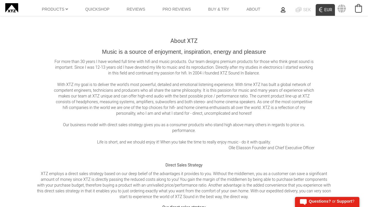

Since you are Swedish, check out XTZ. They make good, or actually really good , subwoofers.:)
Available in matte white:
XTZ is a Swedish company:
