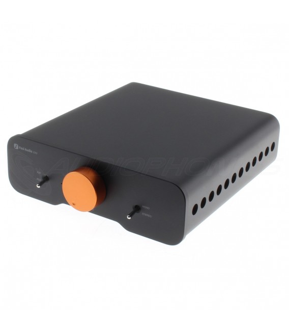

The amplifier has really dressed up from its earlier origins of common enclosures in budget class amplifiers. It looks a lot more "beefy" and substantial. It also looks a lot better with nice series of holes on the sides where copper color is seen through it. Maybe due to these reasons the amplifier kept its cool for the entire test.
On controls, you push the volume control in to turn it on and off. Turning on causes an orange LED to light. Turning it off causes a delay in the light going out even though the output shuts off. Not an issue if you are listening to it but in testing, I am not so it was a bit confusing at first.
There is a misnamed "mono" vs "stereo" switch. Mono doesn't make both channels the same but rather, shuts off one channel allowing for more power in the channel that is left running. The other button is key in book which is support for balanced XLR input to help in avoiding ground loops:
The connectors are combo so you can either use XLR or 1/4 inch. There is still RCA inputs of course and support is provided for a filtered, and volume controlled subwoofer output. Finally we have trigger input so you can turn the amplifier on automatically if you power on your upstream product and it has trigger out, and vice versa.
