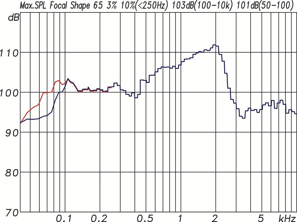

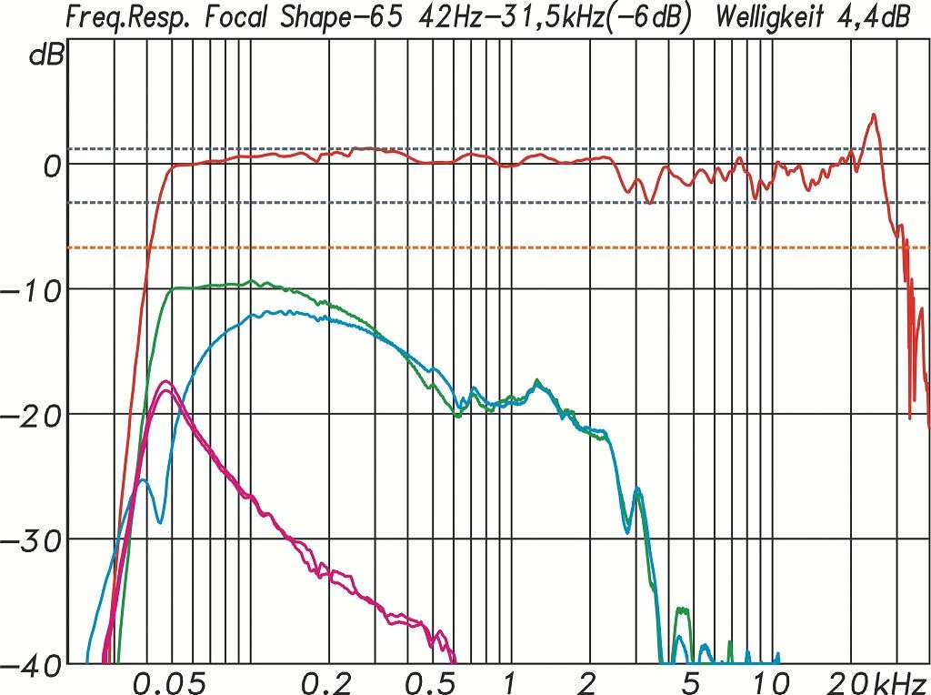

Owned a pair. F3 of 40hz is nonsense, their F6 is above that. S&R measured them. Better resonance behavior though.

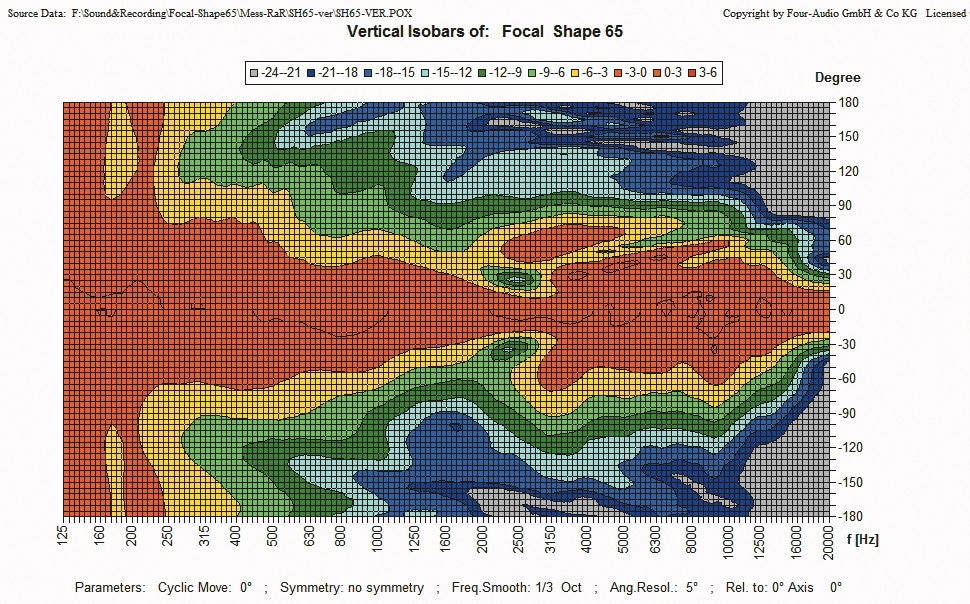

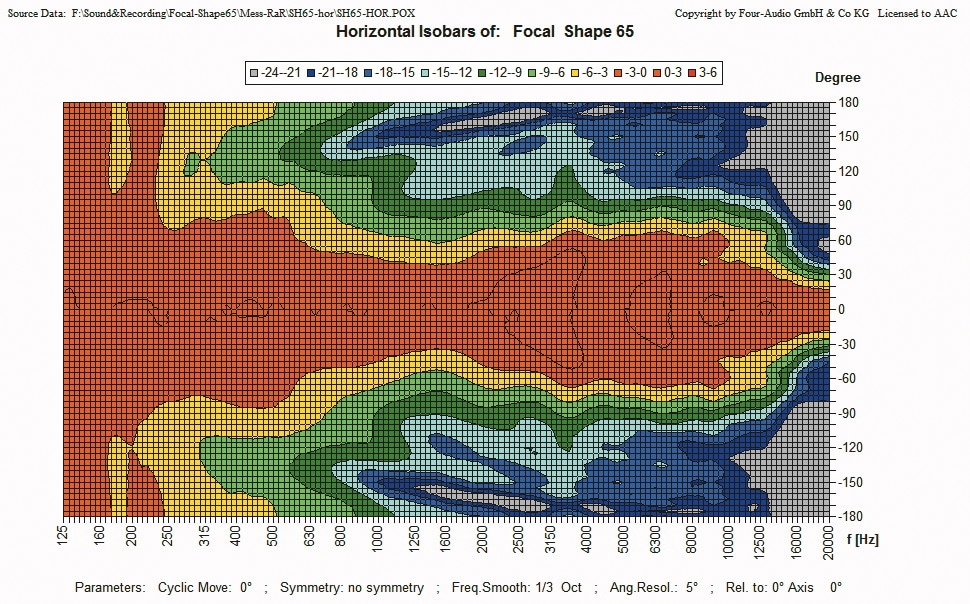

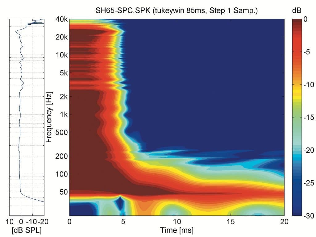

But unfortunately a tad worse directivity and quite less max SPL in the tweeter region though:
