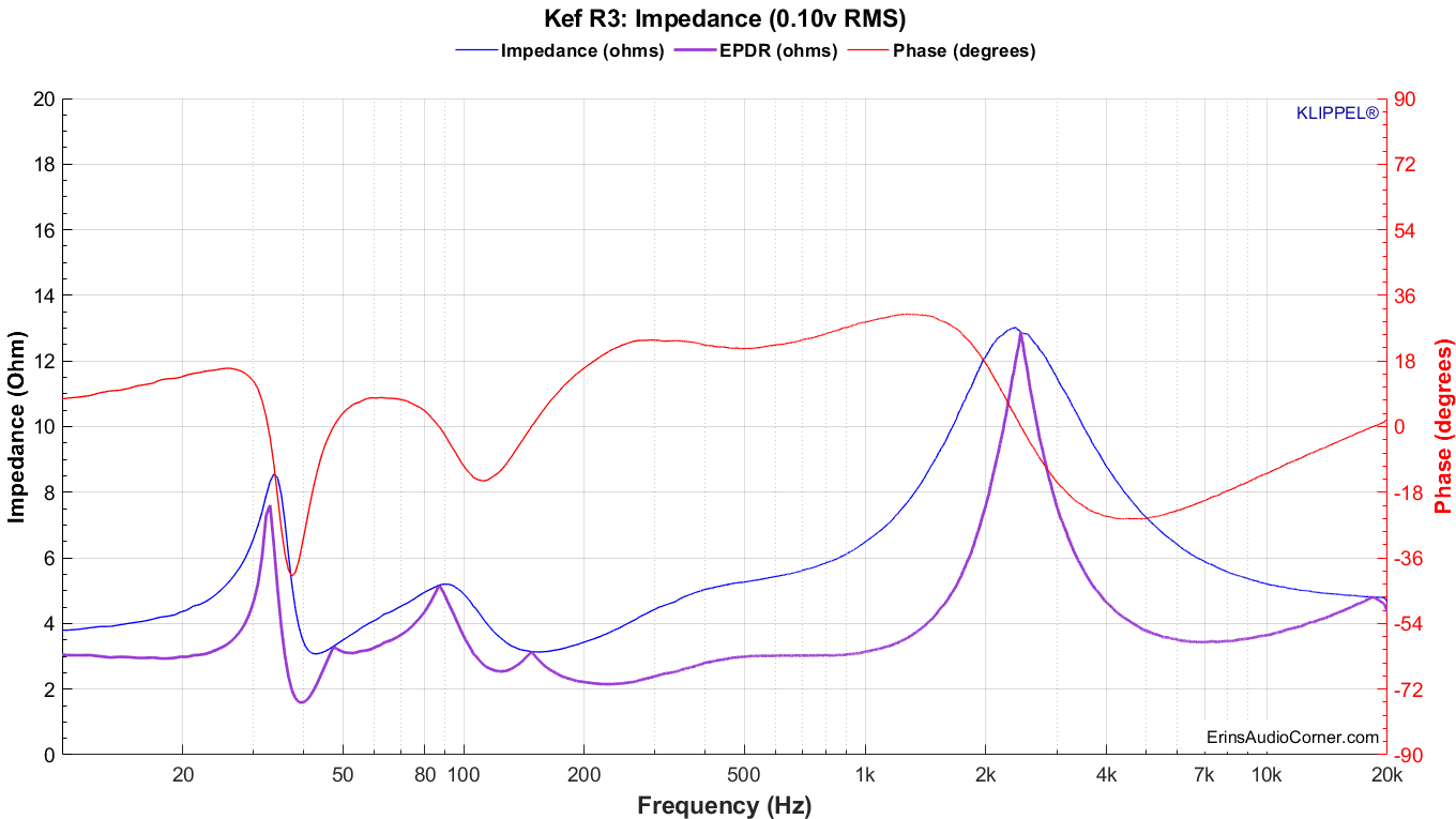

You can even see the EPDR, another term that is overrated by some forum members, even right here on ASR. I don't particular like that term, though I find it useful. I don't like it only because it could and obviously have, confused many who don't fully understand how it is derived and that one could misunderstand the intended meaning/usage.
For more info, you should go right to the origin and don't take some of the forum talks too seriously:
Also see the author, John Mulcahy of REW's:
There's an example of how people could be confused, keep in mind John is probably a real genius, but many of us are not lol..
So take a read, he summarized it (and I though I had seen it elsewhere so likely not his own invention...) as:
"The EPDR value is the resistance that would result in the same device peak power dissipation as the speaker load at a given frequency."
Do all people know exactly what that means? I had to think about it before I think I knew what the original writer was trying to say, and does not mean I fully agree with the principles behind. Yet this terms get quoted all over the map on forums, including by a few that I am sure, as it looked obvious to me (though I could be wrong), don't really understand fully what they were talking about.
Regardless, as @dlaloum , one of those who take DPDR seriously, rightfully so, commented, that it depends on the speakers you have, many of them don't really have to be concerned about the DPDR values. You have those KEF speakers, that I think to be on the conservative side, it is a good idea to check out DPDR for them.
Thanks to Erin:
The non Meta one seems less friendly to the lesser amps, that's why I was wondering which one you have.
Another thing side from "depends on which speakers", it could also be true that if the speaker specs say recommended 50 - 200 W, and you have amps rated 250/400 W 8/4 ohms, I would say you don't need to worry about EPDR of the speaker for the obvious reasons, right?
So, that's any reason I feel EPDR is often overrated, on forums, with due respect to Keith Howard, who first introduced this term, as again, I find it useful. Not really necessary for people who knows the EE theories applicable to amps and speakers designs, but a good tool for many none the less.

Yet these speakers are rated at 8ohm with dips below 4ohm. Should these calculations be done at 8ohm instead of 4ohm?
Sort of my point too, but by now, you understand why I would try to stay away from thinking in terms of Watt, but focus on Voltage and Current. All 3 are of course related but if we stick with voltage and current, there should be less confusing, though for people who don't know much about electrical theory then it really doesn't matter.
By the way, the R3 meta are specified as 4 ohms nominal, with minimum dip 3.2 ohms (and about 1.8 ohms minimum if you look at the DPDR). I couldn't find the specs for the non meta R3 but based on Erins measurements, if "watts" are used, I would use 4 ohm nominal to calculate your power requirement and that's why I got 1,600 W required for one single R3 to give you reference level at your seat, if we use KEF's nominal spec then of course you only need 800 W.
Again, why bother with watts, when we can just use voltage and current to figure your amp needs? It of course will work either way though, if you know what you are doing, and have the necessary information.
