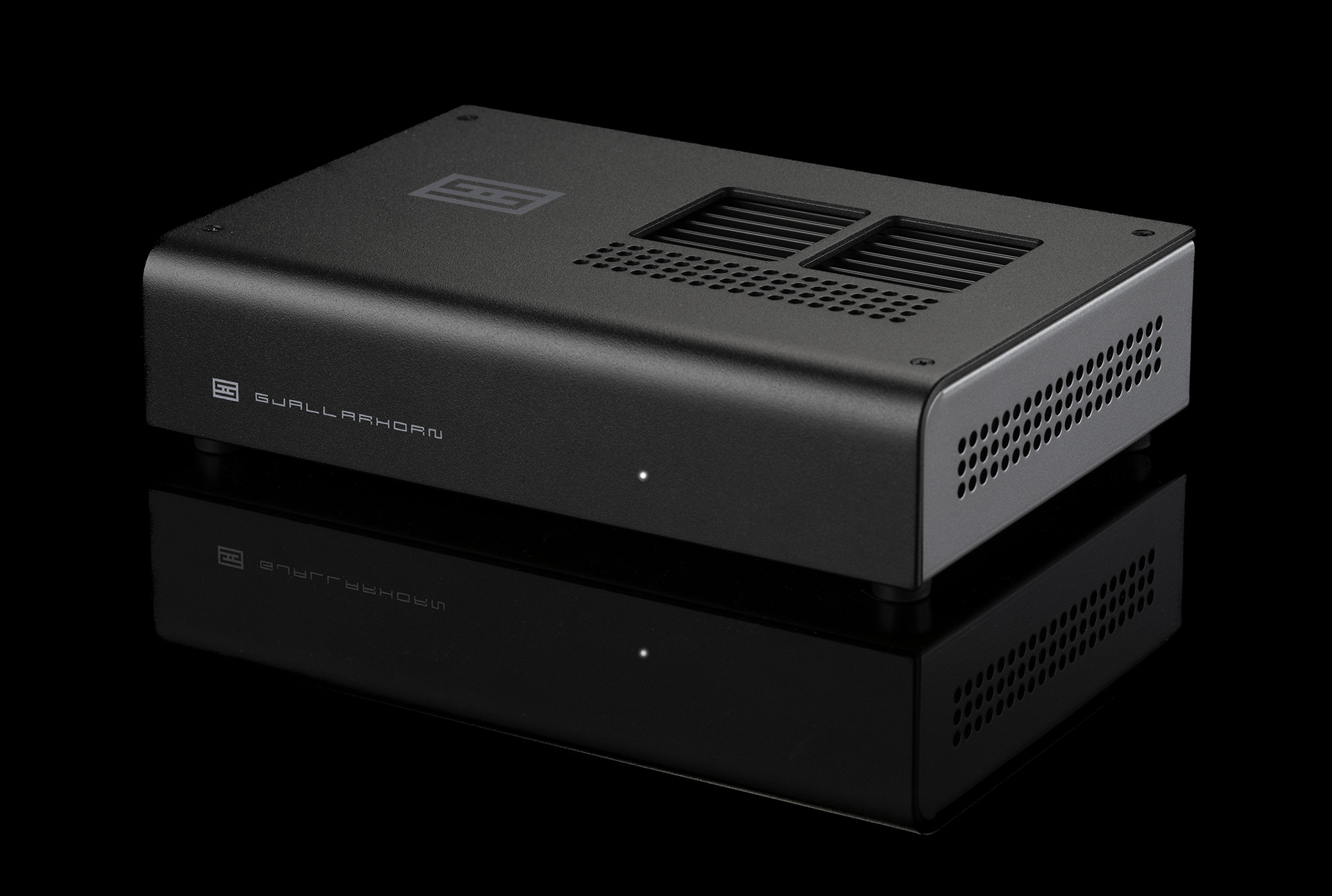

I don’t even think the quantity of watts is a big deal with the Gjallahorn. It’s the quality. Rising distortion starting at 100mW is poor. I have significant doubts about the current-delivering capabilities of it.

So I've been thinking about getting a new power amp, currently I'm using a Yamaha P2500S (250W @ 8ohms, 310W @ 4ohms). My speakers:
View attachment 267947View attachment 267948
I cross these over to stereo subwoofers at 200Hz, powered by a Yamaha P3500S. The Yamaha amps have plenty of power, run cool and reliable, and I really have nothing to complain about with respect to sound. However they produce more noise then I would prefer with my main speakers and I know their objective performance isn't stellar.
IF I need 20dB of headroom, then a high SINAD amplifier option could be the Soncoz SGP1:
BUT IF I really don't need that much headroom, then the Jellyhorn could be a good option too... for much less money...
Either way I would have concerns about reliability from brand new designs, the 5 year warranty from a US company is a major plus for the little Schiit. Concerns about reliability are what hold me back from buying a decent Class-D amp currently, although I am still considering a NC252MP build. I also like the Outlaw 2220 with its all through-hole circuit board build, but It wouldn't be a big step up in measured performance from my Yamaha.
