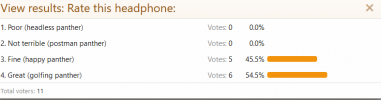

Are we simply trolling these days? Recommending something AFTER eq is just plain nonsense, it's like saying "it's a good car, but you need to change the wheels and suspension"...
Nope. EQ is free. Those mods are not.
Victim of numbers and pure measurements without hint of interpretation or thinking?
Seems like you are that person.
