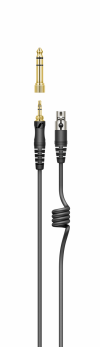

@amirm is the stock cable balanced or I'd have to order a balanced cabe for them?

Here's the stock HD490 Pro cable, which is the only cable included in the box:
read 10 pages and none talked about this xD
The cable has 4 wires and the mini-xlr on the headphone end has 4 poles, but the two jacks are only 3 pole, so not balanced.
You could cut off the jack plug and use a 4 pole jack or XLR connector to make a balanced cable, but you'd need to look into which wire goes to which pin in the mini XLR etc..

I wanted to know if the stock cable (wires) is balanced so I can just buy a balanced adapter
You cannot plug a 3.5mm or 1/4" headphone cable into a differential (balanced) Headphone Amp using a simple adapter.
That can damage or potentially destroy the Headphone Amp.
In case the stock cable uses 4-conductor wiring, what you can do is snip off the stock 3.5mm plug and solder a balanced 2.5mm/Pentaconn/4pin XLR connector onto the cable instead, thereby turning it into a balanced headphone cable.
Whether the stock HD490 Pro cable uses 4-conductor wiring or cheaper 3-conductor wiring, I don't know.
