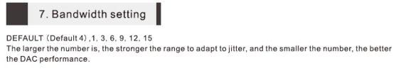

One more question...
7. Bandwidth setting
Default is 4
What this setting change? How can I know which setting is best for me?
