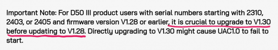

New firmware out. Might have to use 1.28 first before updating to 1.3, make sure to read it through properly
With (usual?) confusing directions:
So… I may have to upgrade to V1.30 before “updating” to 1.28… and then…??? Upgrade back to V1.30?
Translated the Chines version for your reference:
Special note: For D50III product users whose serial numbers begin with 2310, 2403, or 2405 and whose current firmware version is V1.28 or earlier, please be sure to upgrade to V1.28 before upgrading to V1.30 firmware. Directly upgrading to V1.30 may cause UAC1.0 to fail to start.​
Thanks. I think I got what they were saying, but this is the kind of details Topping must get right if they want to lift any doubt about their technical excellence.
the question is where can I find this firmware V1.28? the last firmware version I knew of before 1.30 was version 1.21
The download on Topping's website contains both 1.28 and 1.30:
Also, I think this is a typo:
and should say "it is crucial to upgrade to V1.28 before updating to V1.30"
@TOPPING-Service @JohnYang1997
Could someone confirm? A typo like this in your important note for firmware updates would be really unfortunate..
static already responded but don't forget DFU mode. Remove power, hold in the power button and then insert power into the device.
I hadn't looked in the archive and thought it only contained V1.30, I didn't know that 1.28 was also included - thanks
upgrade went through, I flashed 1.28 and then 1.30
