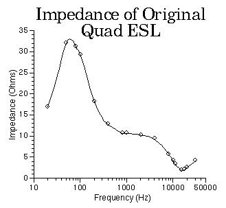

No suprise, because the low (at 10 Hz is over 3 Ohms). As far, as I remember in the 1990s at a test of stereoplay (a german hifi magazin) the low was about 0.5 Ohms.
I think the origional Quad ESL from 1957 is what you are thinking of, with a more demanding load.
quad-impedance-png.60031
