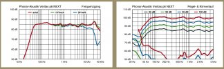

I feel like one of the „other german speaker manufacturers“ so far has been missing in this thread: Phonar from the very north of germany.
Phonar is a much smaller manufacturer (I think I have read something like 15 employees) and thus does not produce the drivers themselves, but use/have used parts from Seas, Peerless, Scan Speak etc.
I consider their Veritas range to be their most interesting series. They use drivers from the Peerless HDS Series and a Scan Speak soft dome tweeter and seem to measure pretty well. Good, easy to use drivers, rounded edges around the tweeter, tilted back cabinets, nice look. Seems like "no nonsense" speakers at prices that are not completely over the top.

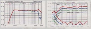

Phonar Veritas M4 next (MSRP: 1.000€)
Phonar Veritas P6 next (MSRP 2.600€)
Phonar Veritas P10 next (MSRP 7.000€)
View attachment 259907View attachment 259908
View attachment 259909View attachment 259910
View attachment 259912View attachment 259913
