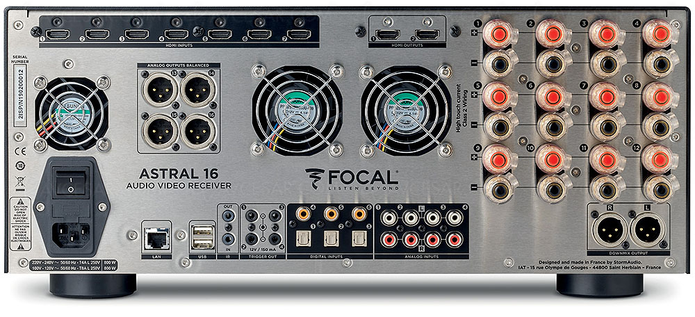

Storm Audio also works with Focal look here at the (AVR) Astral 16 (20 000 euros)
