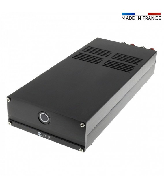

could you please list a couple of amps on nCore for the $400-$600 range?
Here are some.

Here are some.
