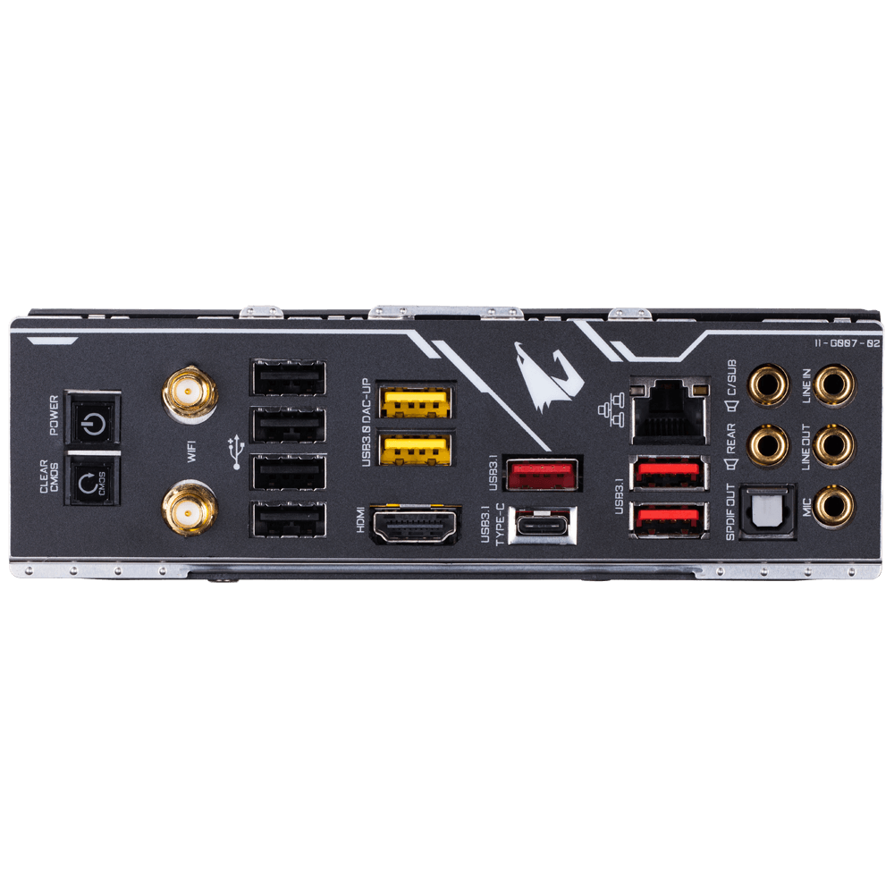

Have you tried using the yellow color port? The DAC-UP ports are supposed to be especially clean and free of noise/interference.
https://www.gigabyte.com/FileUpload/Product/2/6637/2018100517194938_src.png
Yeah, I have. If you use the default function of those yellow ports, it's the exact same as a normal USB port. If you go into the BIOS, there is an option to disable USB power or provide up to 0.3v of extra power. If I disable USB power, the DX3 Pro doesn't think it's plugged into anything so it doesn't process the data signal from the computer, which sucks. I wish the DX3 Pro didn't require the 5v to sense that it was plugged in. That would be amazing.
Quote from Gigabyte:
GIGABYTE USB DAC-UP provides clean, noise-free power delivery to your Digital-to-Analog Converter. DACs can be sensitive to fluctuations in power from the other USB ports, which is why GIGABYTE USB DAC-UP takes advantage of an isolated power source that minimizes potential fluctuations and ensures the best audio experience possible.
https://www.gigabyte.com/mb/100-gaming/Audio
It have isolated power handling so that there isn't any extra dirty noise on the USB signal potentially interfering with USB DAC.
Maybe your motherboard or case have grounding issue.
Interesting. I don't know exactly what they mean by "isolated power source" cause it's still using the same mains as the computer and the buzzing sounds just as bad when I'm plugged into the DAC-UP ports with power enabled on the port.
