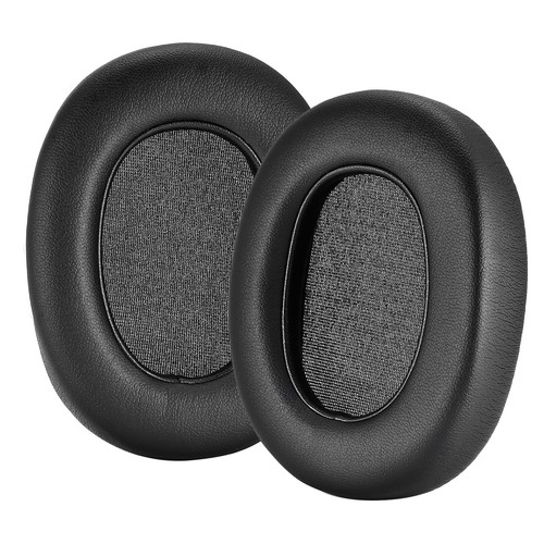

I took a look about pads on ebay or aliexpress, there is a lot of options for pads looking similar to original ones.
I choosed these ones as the seller have good recommendation :
Like the post before, they are very close to the original ones.
There is blue foam whose density feel the same. The synthetic leather is identical, as the dimensions.
They sound very similar although I prefer the replacement ones as they are not worn out I guess : tighter bass (better seal ?) and less bright upper trebble : with the original pads the cymbals are harsher.

I am happy with ebay replacement pads, precisely these ones : https://www.ebay.fr/itm/385805018749
When I compared to worn originals, the sound was the same.
