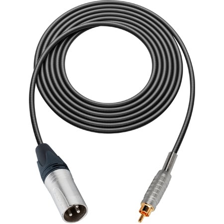

Amir, thank you for another AVR review. Do you have a good RCA to XLR cable now to try and test the combo of AVR pre out + your external XLR input only power amp? It would really be a good test because a lot of us (not me) do use our AVRs that way.
I don't think I ever built one. Is there one off-the-shelf?
I have bought and used these to hook some pretty disparate components together when COVID-19 forced us to Zoom (only) services at our church back in 2020. I thought they were just dandy. I presume they are also available as RCA female to XLR male, as well.
