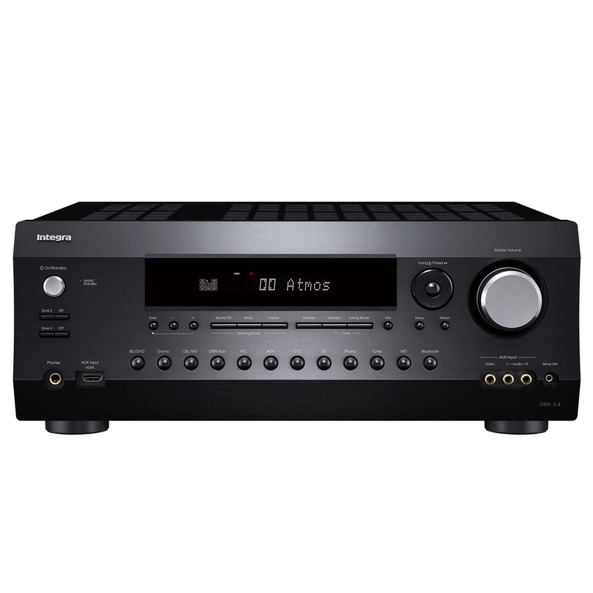

Adorama (via Slickdeals) is currently showing inventory of new samples of the Integra DRX-3.4 with a 5 year warranty for $749
Adorama, again via a link at Slickdeals, is currently selling new samples of the Integra DRX-3.4 AVR with preamplifier outputs for all channels, a paid Dirac Live license and a 5 year warranty for $649

The Integra DRX-3.4 AVR is eligible for this firmware update. Adorama (via an affiliate link from Slickdeals) is still selling the Integra DRX-3.4 with a paid Dirac Live license, preamplifier outputs for all channels, and a 5-year warranty for $649. I do not know if the Integra DRX-3.4 will eventually support DLBC or not.
I just upgraded my 3.4 without issue. Also, there's a new Dirac Live beta that just dropped a few days ago: https://www.avsforum.com/posts/63612411/
