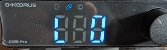

The ok button cycles through to there but that's also needed to reach input selection...
hmm ok but why is it there to begin with? i mean, it's extremely unaesthetic to put it on top of the amp
Yep. Could it have to do with one of those modes where it basically is going full tilt?
Also these two modes are mystery and I am afraid to test now

Ok so one very unpleasant suprise; no manual is included with the amplifier @Alexander Lin and in going through the remote options I came across one that suddenly put the amp into full volume mode. I hope it did not damage my ears or speakers. I was exposed to the loudest sound ever for a short time. Highly unpleasant and worrisome.
If my son triggers that by accident for example. But for now I am really wondering whether my hearing was damaged by the incident. I was very close to one speaker.

The precision of the electronic volume is 0.5db. When the left and right channel balance is set to 0, the gain is 29db, and the channel balance changes by 5db from (-5) to (+5). For example, if the volume is set to 50, the left channel balance is set to (-5), and the right channel is set to (+5), the actual left channel is 45 and the right channel is 55. However, the volume display is still 50.
