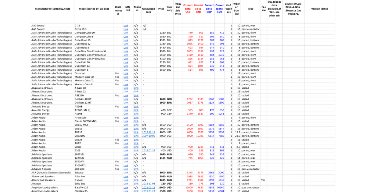

From the Sweetchaos sub comparison spreadsheet the SB 2000 measured by Brent Butterworth achieved 95.1dB at 20Hz so 15dB better than the Kef.
