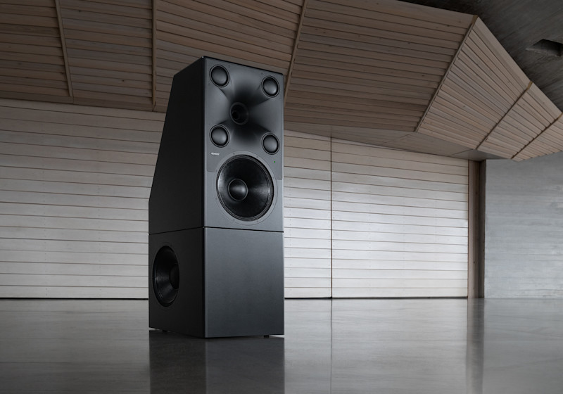

New Danley Studio Monitor: TDH-3
Apparently because it follows the same design principles as (for instance) the Danley SM60, using a coaxial to seamlessly combine both high and midrange frequencies through midrange taps in the horn, as well as some Danley crossover wizardry.

PA OEM coaxials are not known for smoothness at HF compared to domestic/studio implementations from Genelec/KEF. A compression driver isn't as smooth as a direct radiator in most cases, and definitely not in a non-optimised coax without a highly optimised cone, throat and surround geometry as with Genelec/KEF
Well yes, and usually distortion at base levels is higher as well, but they can go way louder, and the sound field and compression characteristics are actually much better suited to match with a good horn. How smooth the result is, is usually highly dependent on the horn and the shaping of the response. If you look at the small B&C Coax referenced earlier, the HF response looks absolutely horrible. With the Danley horn, I'm sure it is much, much smoother. The rest, you can EQ, or you will not hear anyway. I think lots of the complaints for compression drivers stem from the less-than-optimal voicing, and the fact that you usually hear them in (often crappy) PAs.

Or their new flagship:
The comparison was with Genelec coaxials. The Genelec coaxials are clearly much lower diffraction than any measured Danley

I am not sure what exactly is "them" but Genelec S360 is not using an OEM coax driver. It has a 44 mm/1.7" dome compression driver with a 25 mm/1" throat in our custom DCW (machined directly into MDF cabinet), paired with a 10" woofer in non-coaxial arrangement. There is no Genelec model using an OEM coax driver, all of our coax drivers are designed and manufactured in house. Thank you.
OEM or otherwise is irrelevant. The point is that compression drivers can give smooth output, as Genelec (and others) clearly show, with or without coax. Kudos for building your own, though :)
Even when we look at OEM coaxials, the OEM ones are usually crappy because they are not properly integrated. I've seen plenty of examples where a properly integrated version gives vastly different responses and off-axis smoothness from the factory datasheet. Nevermind if you change out the horn completely.

Genelec is using a very clearly well designed low diffraction/HOM geometry -- be it for their compression driver tweeters, or coaxial drivers (with the smooth flush transition between tweeter and midrange), or quasi-coax arrays.
Danley's solution is clearly nowhere near as sophisticated and smooth on the driver/horn geometry level.
I said “well yes” the first time ;) Clearly KEF and Genelec have way more resources when it comes to product development. But that doesn’t mean Danley’s solution is bad. It will probably be a lot smoother than what we’ve seen from the SH50 for instance (see Erin’s review). Certain it will be much better than the OEM datasheets seem to indicate. And that was my main point: good integration is key. You can take it to the next level as KEF and Genelec have done for sure, but only a few companies can do that.
I said “well yes” the first time ;) Clearly KEF and Genelec have way more resources when it comes to product development. But that doesn’t mean Danley’s solution is bad. It will probably be a lot smoother than what we’ve seen from the SH50 for instance (see Erin’s review). Certain it will be much better than the OEM datasheets seem to indicate. And that was my main point: good integration is key. You can take it to the next level als KEF and Genelec have done for sure, but only few companies can do that.
