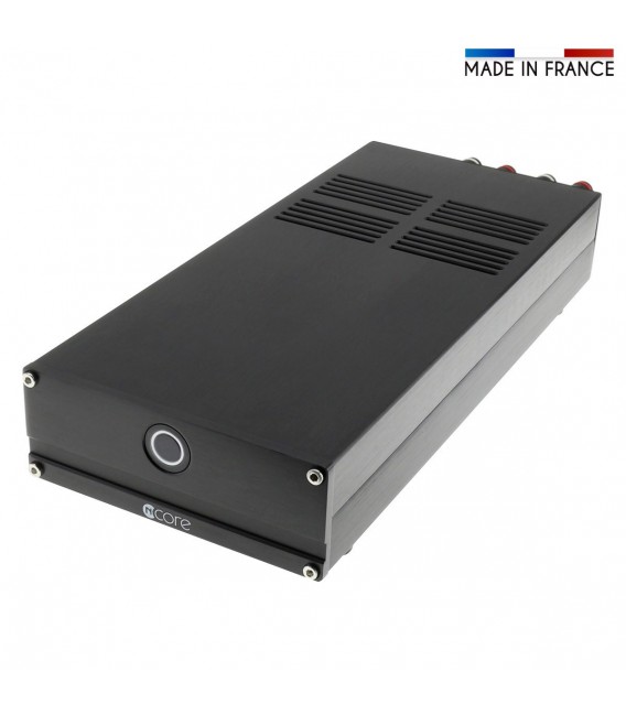

Hypex doesn't seem to give you what you're searching for (2x 200+W @8Ω for ~400€ in Europe).
A Hypex Amp in Europe can give you 2x 75W @8Ω for 400€, or 2x 150W @8Ω for 480€:
FWIW, both of these come in an XLR version as well.
I havent really delved too much into hypex yet as there are a lot of manufacturers making amps and kits with their modules so its a bit overwhelming, which hypex based amp would you recommend that fits what im looking for?
I'm not in europe so not familiar with what the various module builders' offers are there particularly....but I'd check with Nord and Audiophonics perhaps.
