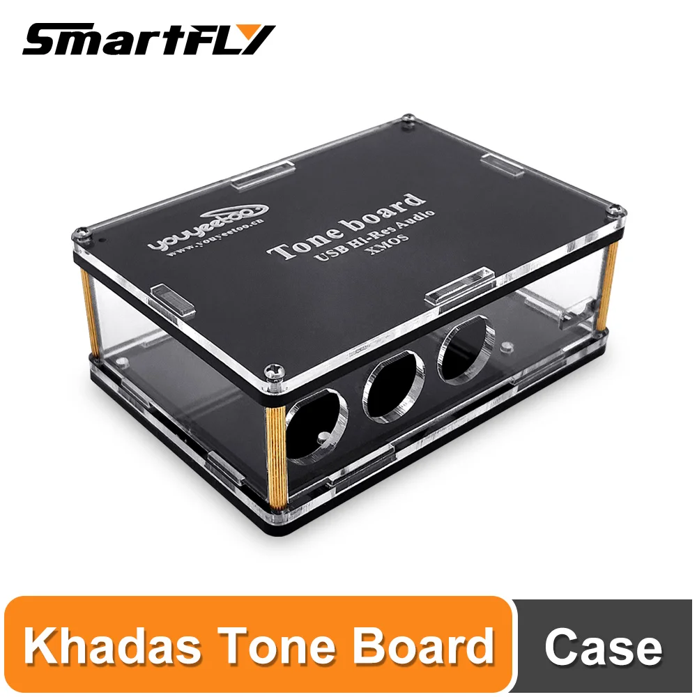

Is this a case for the group purchase?
View attachment 33974View attachment 33975
Since i i'm not able to create enclosure for KTB, like this project and signing for the orders.
That is not an available case. It is a model created by Electrohm as far as I can tell. The only cases available commercially are the purple plastic one Khadas sells, The other acrylic topped one that says yeewee or something like that on it, the aluminum one shipping from France and Canada, and ones you can have printed for you via the 3D printed thread.
I am new to all this, but I have a background in fabrication, so I am interested in machining one to match the Atom amp, but I won't be able to make more than 1. The one Electrohm was talking about getting from China (i.e. the one you posted), will likely never get made as they require a purchase of 500 units.
if the writing is offensive, it looks symmetrical enough that you can simply turn the top piece over and it will be hidden

Hi
have you tried this box ?
I saw that reviews are not good:
"It's not the cheapest case, and the quality is not great. The elements are not realy precise crafted and do not easily fit each other. The bottom plate was missmatched with black one, and I can't put the walls in holes. That lead to two breaks. Overall I can't recommend this product. "
"described but I'm disappointed in how poorly the plastic pieces fit together. In fact, I broke the bottom plate slightly trying to place the front panel into the case. It does take a bit of time to assemble and it's a bit of a nuisance getting it together when the pieces don't quite line up. Once assembled it looks good. However, I'd caution people looking at this since there are so many positive reviews (I wonder if any of these people actually put it together.) "
