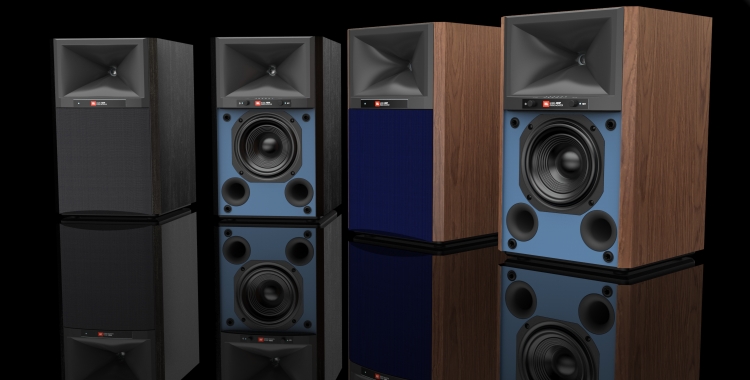

At Last JBL presents an active home/pro speaker
Wireless
AirPlay
Cast
BT
Aux
And from what I have seen it has ruler flat and excellent dispersion response

4305P has D class amp 25W to each compression driver and 125W to each woofer, includes a Bluetooth handheld remote control and can be controlled as part of a Google Home or Apple Airplay ecosystem (wired and wireless network audio capabilities via Ethernet, Google Chromecast Built-in, Apple AirPlay 2, and Bluetooth audio.).
a 24-bit/192kHz high-resolution DAC render MQA audio files and is certified Roon Ready,
Asynchronous USB and optical digital inputs, and a 3.5mm analog input. analog input with combination XLR / 1⁄4-inch TRS phono connectors and a selectable input sensitivity switch for use with balanced or unbalanced signals.
Interesting, looks like each speaker work separately as single unit, so then 1100 for single unit and can be used as mono. If proper discount it could work.
Undoubtedly this on-axis response is via DSP. They did a good job on the directivity other than the 1.5 dB dip in first reflections at 2 kHz and 2 dB peak in sound power at 1.8 kHz which I assume is around the crossover frequency.
I wonder is JBL has any magic to make a 5.25" woofer happy to 45 Hz. Perhaps they just tuned down the Fs with added cone mass? They are giving the woofer a lot of amp power. I would still guess that this speaker gets unhappy in 96 dB testing, but would be pleased to be proved wrong. Check out that steep roll-off (48 dB/octave eight-order?).

125 to the woofer sounds about right to me to ensure higher spl with what is likely a fairly beefy and thus less efficient woofer. Plus required to accommodate bass boosting in the DSP.
I am sure that 45hrz is a combination of woofer design, tuning and DSP.
Tune the system right and you can really boost it with DSP right above fb and then cut it way back to minimize excursion below tuning.

The tweeter is a step down (likely same as JBL HDI and the less expensive Synthesis in walls) and it is yet to be disclosed if the woofer is a spin-off of 705’s neo monster. However it’s hard to argue with that Spin. Depending on dimensions and available finishes this one could be a formidable Neumann/Genelec competitor for desktop systems.
The 705P horn and cabinet look smaller. If so, for some people the 705 could be more home friendly. Also, the 705P has 250W x 2, one amp on each driver.

Nah, that hurts the efficiency.
What you do is EQ your actual woofer with a Linkwitz Transform to drive the vented box like it's the 10" of your dreams. The 4305P's main limitation will be the volume you can surrender for ports, which keeps you from going too deep in 10L. Still, the ports buy 4-6dB efficiency, while giving lower response, and all you needed was a little simulation & IIR EQ
Of course, this paints you into a corner in terms of SPL. Your driver probably can't push 100dB at 50Hz, and you'd complain about noise from the small ports if it did. Either way, you use the same fix: as output rises, reduce the bass excursion with a variable-frequency HP rolloff.
SPL/extension is always a tradeoff, but the DSP lets it be adjusted in real-time. Beats the heck out of a heavier cone.
