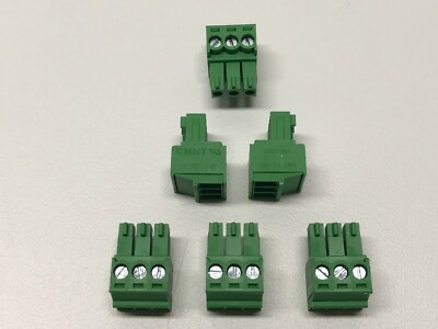

To just use these XPA amps to run a stereo pair of speakers is not as complicated as it first appears.
The reason we have to search for the little plastic terminal blocks that plug into the back is because when the "pro" installation monkeys remove them for an up-grade, they don't take the time and care to perserve them. Or perhaps reuse them when possible.
The 2002 you linked is a little different than the 2001 I am using and uses different pin configurations, but they are avail. Here's the ones you will need.
Inputs would be;
The speaker out-puts would be;
The nice RCA adaptors Rooskie linked will not work on the 2002.
After you get the the terminal blocks in hand, one end of an RCA cable needs to be lopped off and stripped down to bare wires so it will go into the terminal slots. It sounds harder than it is and yours would be more simple yet as there is no cross-channel balancing. The biggest prob. I had concerned my fat fingers.
